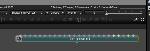

Exporting from a plugin to Standalone options are....(and I don't know yet which of these the DazStudio plugin implements)
1) You can export a single frame from a plugin to OCS or ORBX. That single frame may have an animated camera (the Modo plugin for example) IF the plugin loads the camera track for a single frame - and in this case, Octane Standalone will show a timeline slider. That single frame can also have animated transforms. If there is no timeline slider in Octane Standalone, there is no animated data in the OCS/ORBX.
2) You can export an animation from the plugin to OCS or ORBX - NOT using Alembic. In this case it is simply 1) but with the camera and transforms animation data loaded by the plugin. Again, the Modo plugin has this option (but maybe no others) - and it provides object and camera motion blur in Octane Standalone, but not vertex motion blur.
3) You can export an animation from the plugin to OCS or ORBX using Alembic. In this case there is generally no animation loaded into the object transforms (since they will have world space vertex motion blur). The vertex positions will be exported to ABC. The camera animation can either be via the animation used in 2) above, or can be via ABC.
For your specific problem you need to determine if the camera track has any animation, or if it was stored in an ABC node. In Octane Standalone you can determine this by a) if there is a camera track in the ABC node, there will be a camera output pin in the ABC node. And b) if you copy and paste the thinlens camera into a blank scene in Octane Standalone, if it has an animation track the timeline will display.
