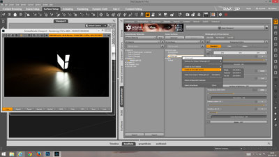

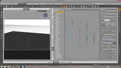

- You can create materials in the OcDS Node Graph Editor - NGE.
Just hoover with your mouse on the right side of the pane Octane Node Graph List to expand it.

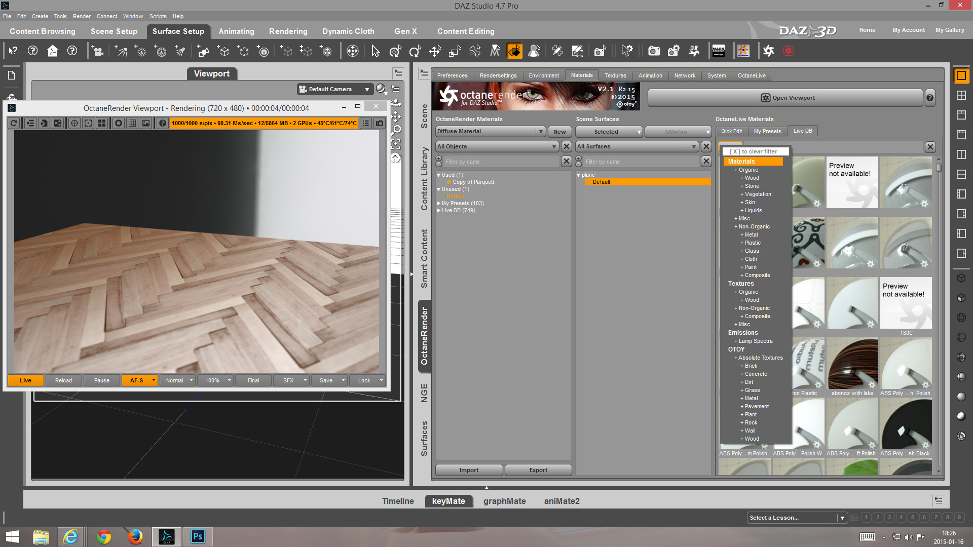

There is also a huge selection of preset shaders in the OctaneRender live db.

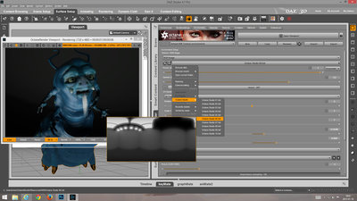

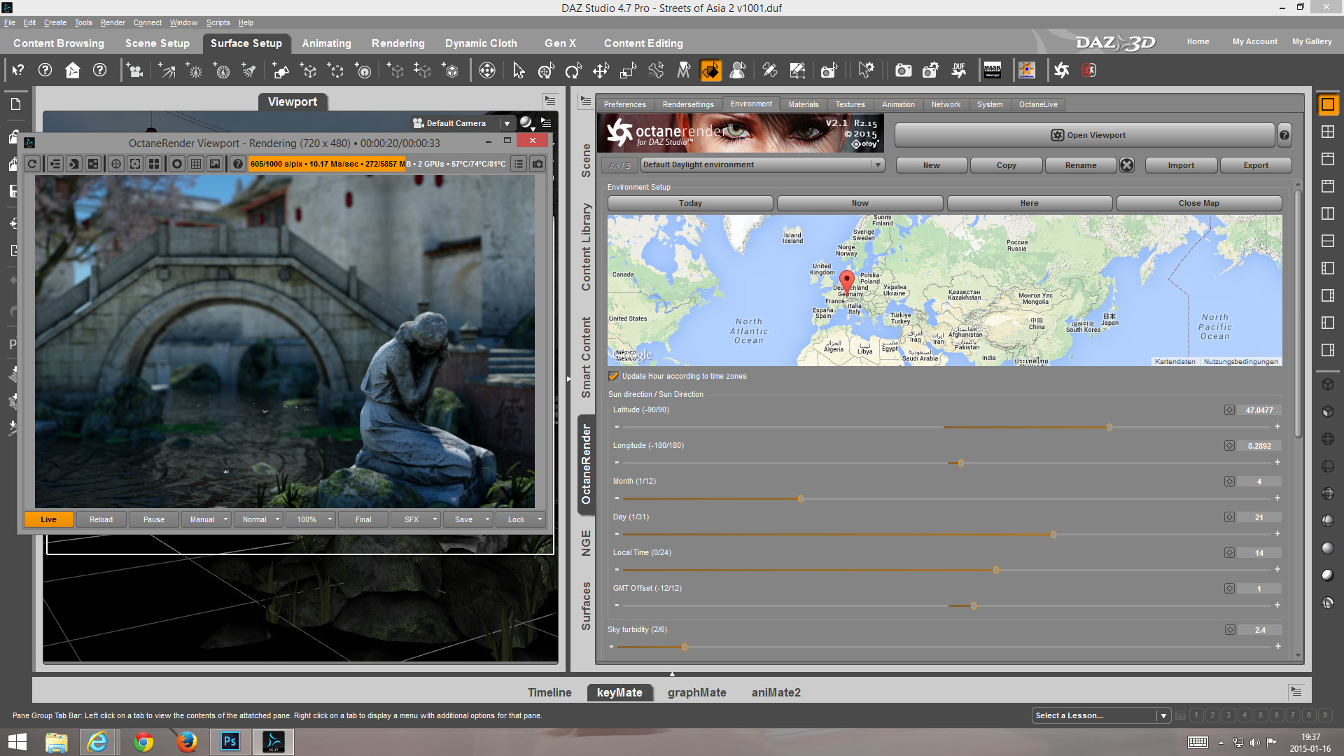

For outdoor scenes you can use the default daylight environment.
the default daylight environment for outdoor scenes features even a world map.jpg
The position of the sun is simulated based on day and hour.
You can even select a specific position on the world map.

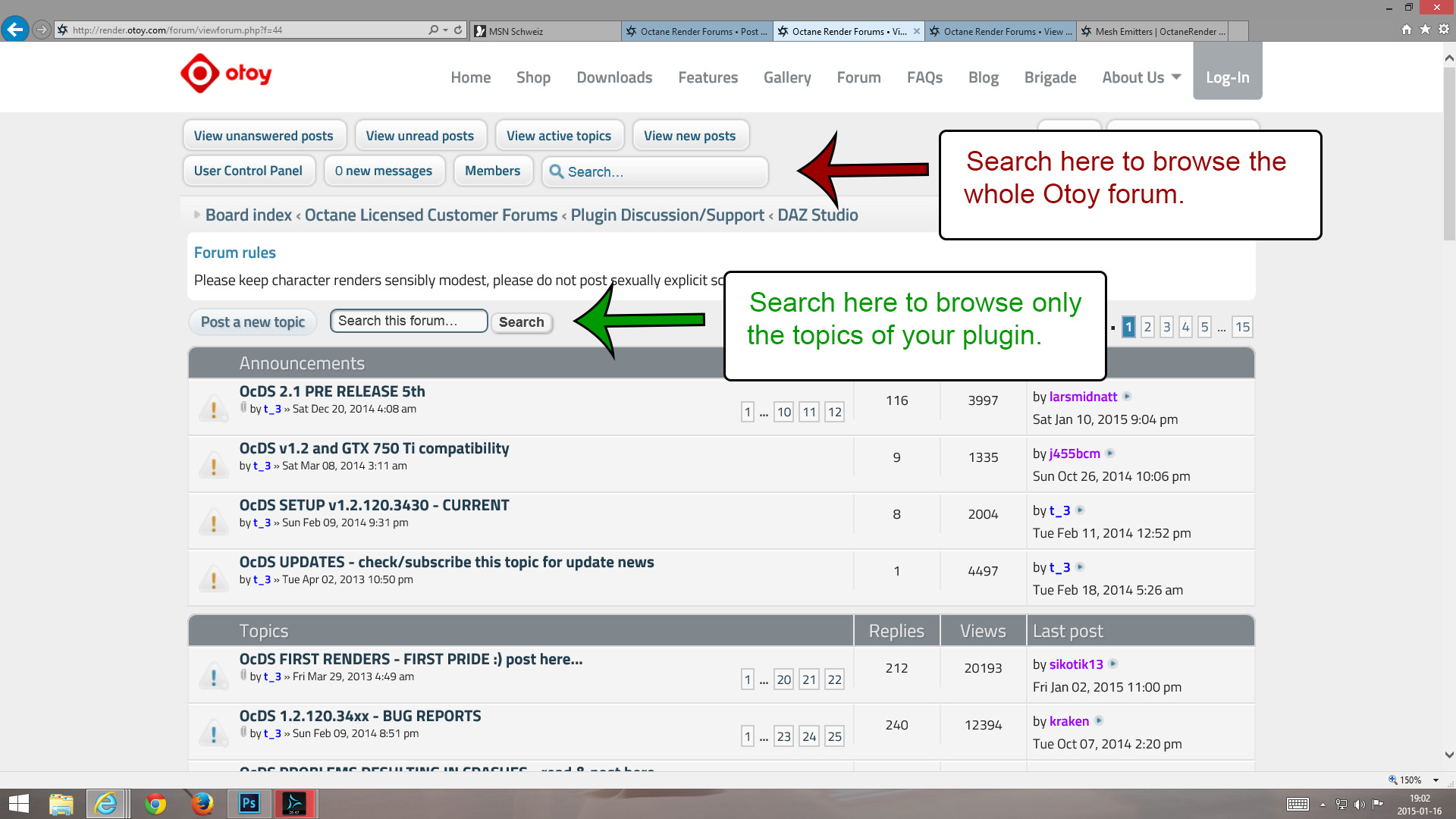

There is actually a quick way to find only information about the plugin you are using without displaying all the other information about the standalone and other plugins.
Each OctaneRender plugin forum has its own search function.
If you use the top search bar results of all OctaneRender forums will be displayed.
But if you only want to find topics about the DAZ studio plugin use the DAZ studio plugin search function.

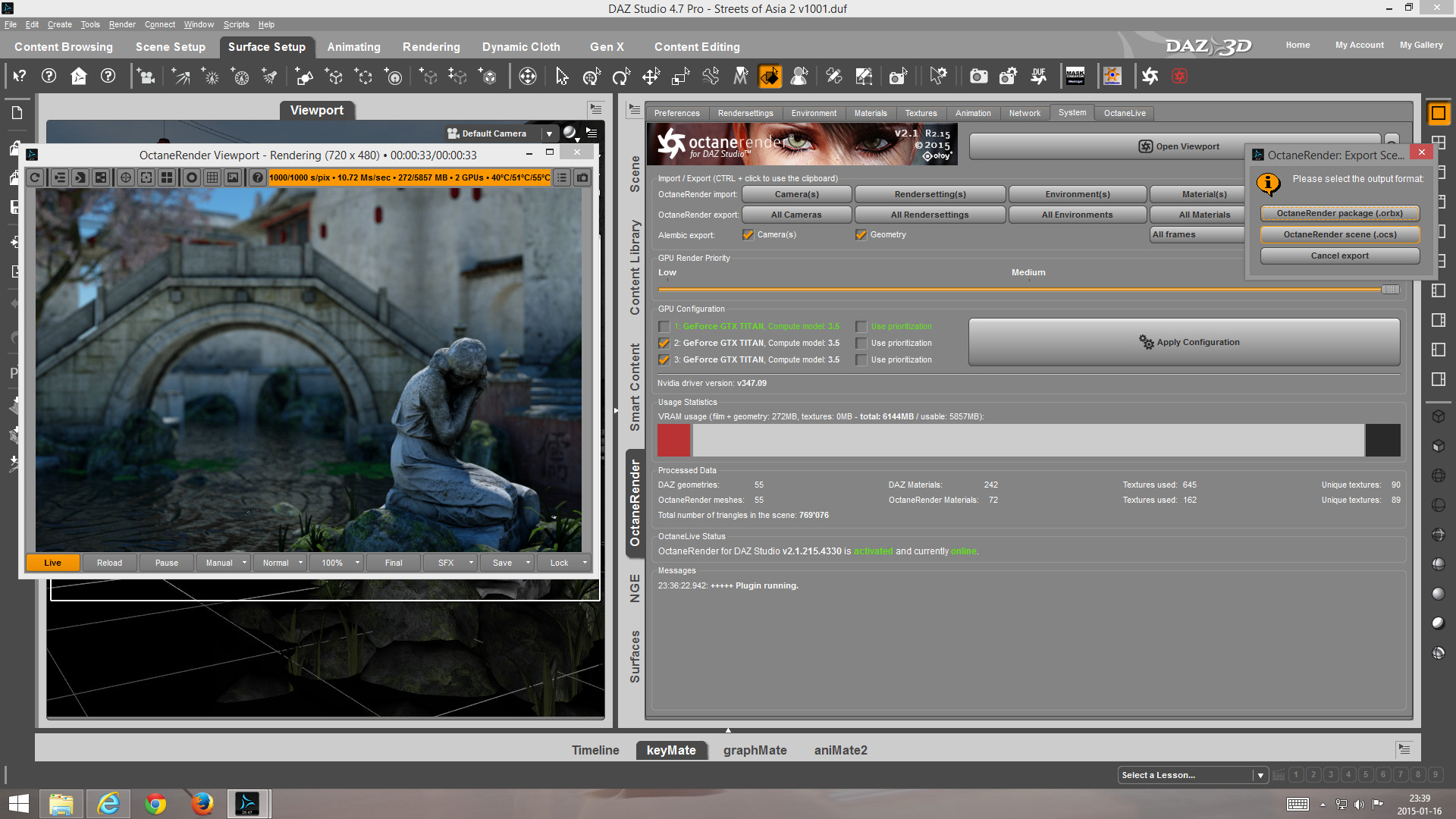

You can set up a complete scene in the OctaneRender plugin for DAZ Studio with all materials and then export it as either an .ocs or .orbx file.
The .ocs file will create a separate folder with the geometry.
The .orbx file is a packaged version.

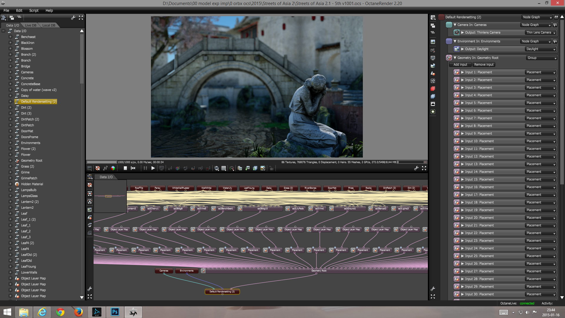

In test scene Streets of Asia 2 the folder with the .ocs and the geometry was 90.4 MB.
The .orbx was 136 MB.
I have not yet figured out if the ORBX includes some additional information that is not available in the .ocs file.
For now I assume that both the .ocs and the .orbx can be used for the standalone.
In the future the .orbx file may be the prefered container to upload scenes to the octaneRender Cloud edition.
When you open the scene in OctaneRender standalone the scene should look exactly the same.
Create the scene in the OcDS plugin and then as a very last step export it to the standalone to add some features that are not yet included in the plugin.
