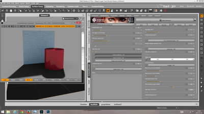

Just set "Matte" to "ON" in the material options of the surface that you want to catch the shadows with.
Example:
The ground plane material is set to "Matte - ON".

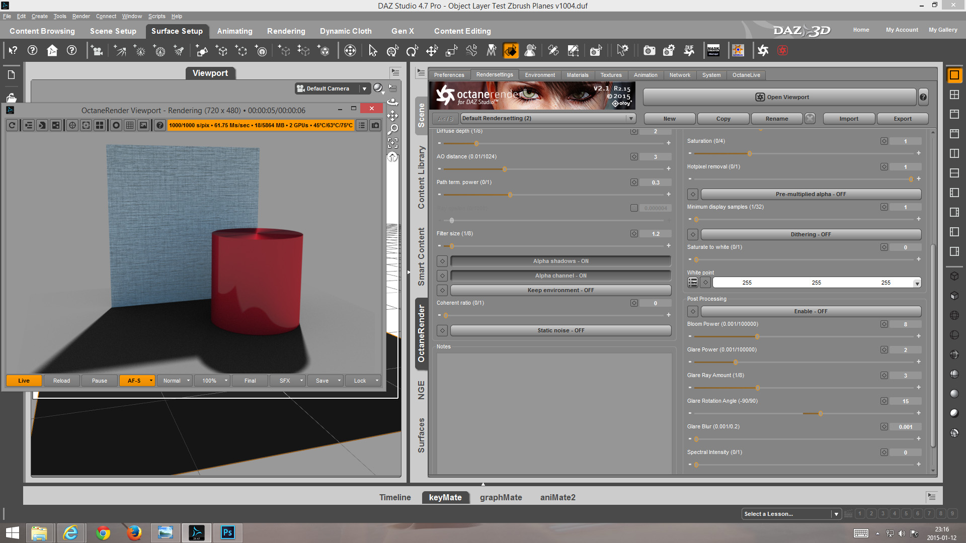

And in the render settings set
Alpha Shadows - ON
Alpha Channel - ON
Keep Environment - OFF

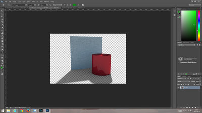

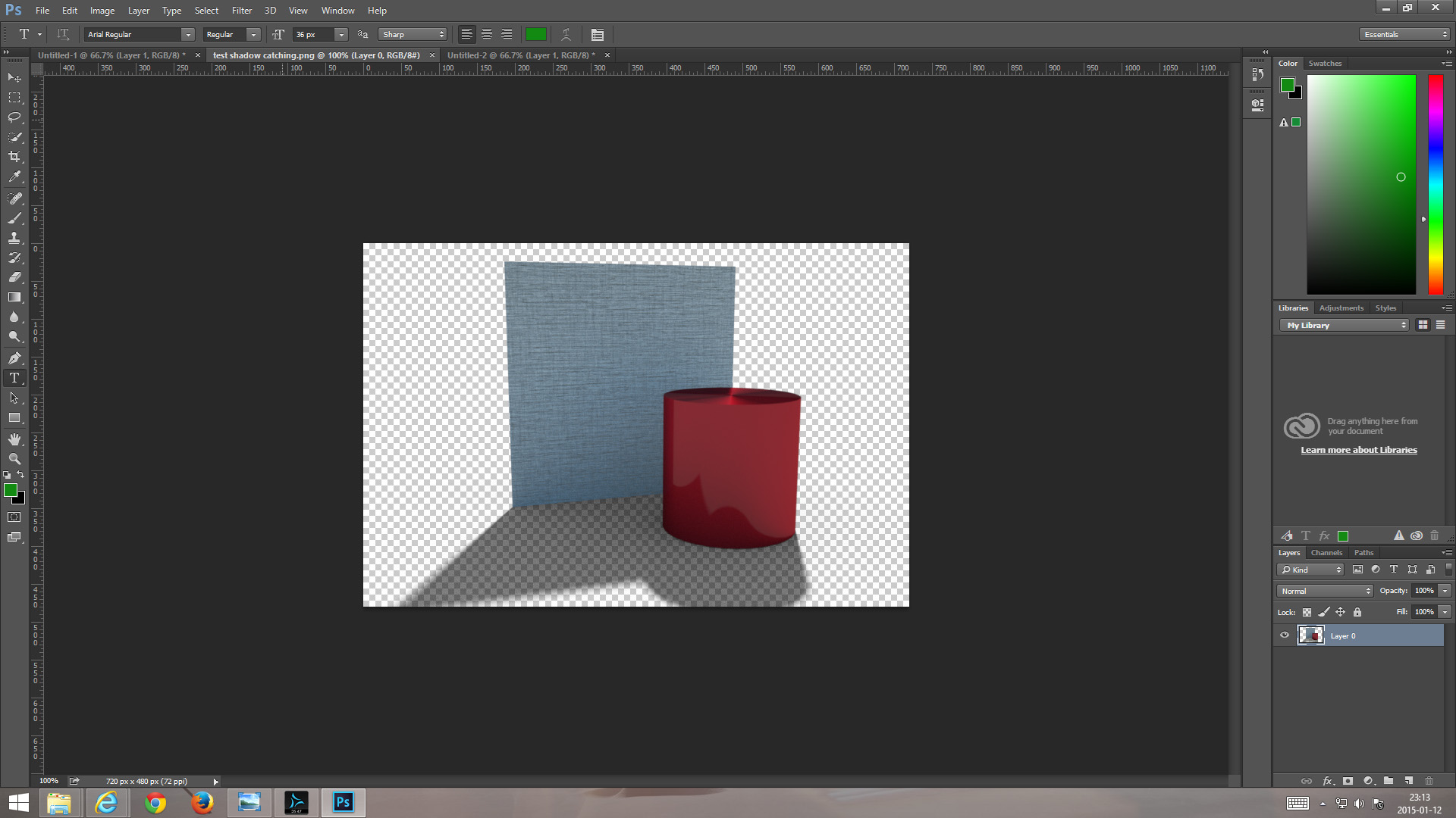

The resulting file in photoshop:

Make also sure to set "Keep Environment" to OFF for clean shadow borders.
Or the environment may show trough as in the first image example.
