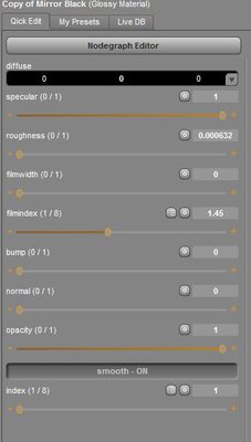

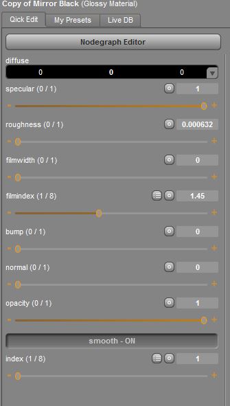

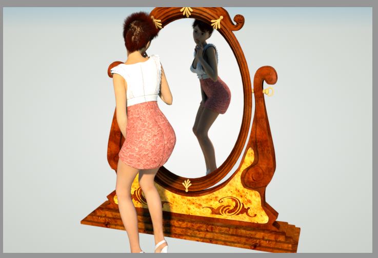

Is this what you had in mind?
Mirror test
Mirror test
settings
settings

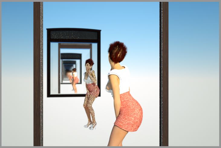

Location: Chicago, IL
I realized that after I posted. With your update it appears you have found a solution and yes the white mirror was the one I used.
Mirror 3
Mirror 3
Spectralis
Posts: 561
Joined: Thu Jun 06, 2013 10:21 pm
Tugpsx wrote:I realized that after I posted. With your update it appears you have found a solution and yes the white mirror was the one I used.
That looks great. Exactly the effect I was after. Did you change the 'Mirror White' material to specular? Did you make any other changes? I'm not sure whether I've figured out the optimum settings for this effect yet.
