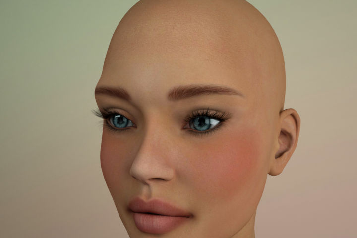

Tugpsx wrote:t_3 Now these look fantastic. We would all love to learn how you got these. Tutorial :twisted:
the bottom one is a foto;
mentioning this just in case ;)
rather than giving a tutorial, i'm going to add the mats to the plugin; as presets, or in a completely set up demo scene - once they are done.
the full version is here btw: http://render.otoy.com/forum/viewtopic.php?f=5&t=38674

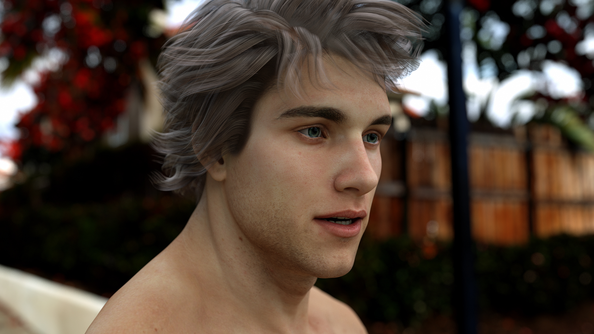

Just want to say thanks again for the help and sharing your solutions. Sharing an image I did the other day :)

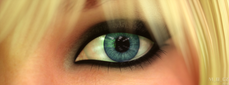

I did some testing myself and after trying many things (including creating my own custom eye objects with adjusted mappings and so on) I basically started using a setup where:
Iris and pupil are default diffuse materials converted by the plugin. EyeSurface/reflection surfaces are disabled.
Sclera is glossy:
With Diffuse and Bump maps applied.
Spec 0.3
Roughness 0.05
IOR 1
Cornea is Specular:
Reflection 1
Transmission 1
IOR 1.38
Filmwidth 1
Film IOR 1.33
Roughness 0
Results are relatively OK
EDIT:
I included a closeup of the eye rendered using the same material setup as listed above from a different scene. The reflections are there but on the Cornea they are still quite dull. :(
