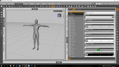

Michael 4- surfaces 2008

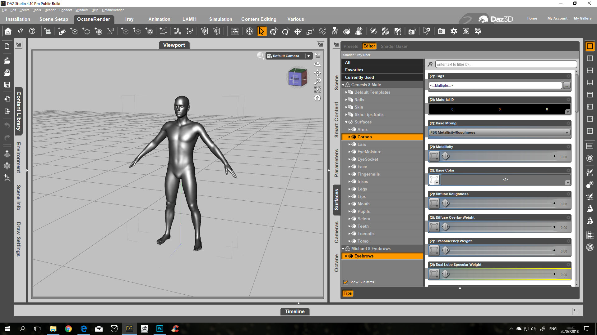

When rendering the Genesis figure released in 2011 it was a common practice to use the "Clear Cornea" material from the OctaneliveDB.
-> For that to work the users had to remove the "Cornea" entry from the Surface Material Filter.
-> Most users of that time should be aware to adjust the Surface Material Filter based on the generation of figures to render.
Genesis surfaces 2011

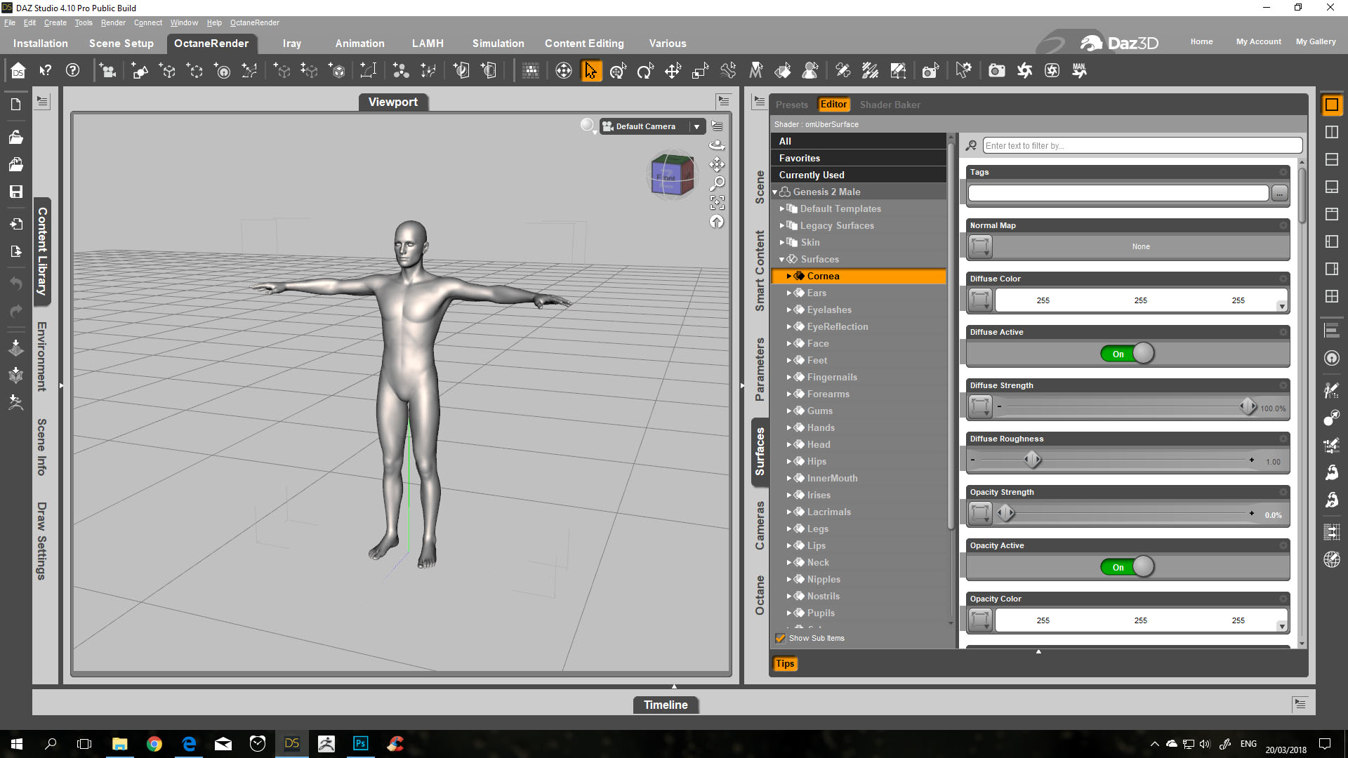

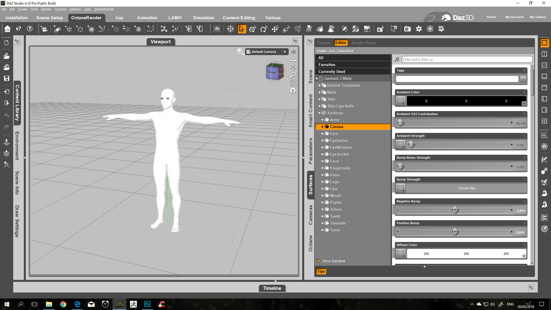

With the introduction of Genesis 2 (2013) and Genesis 3 (2015) it also was not needed anymore to hide the Cornea.
Genesis 2 - surfaces 2013
Genesis 3 - surfaces 2015
