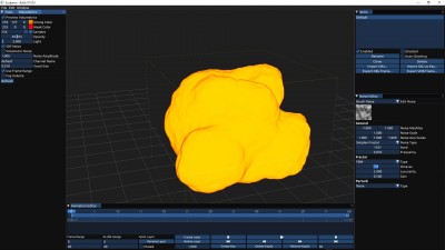

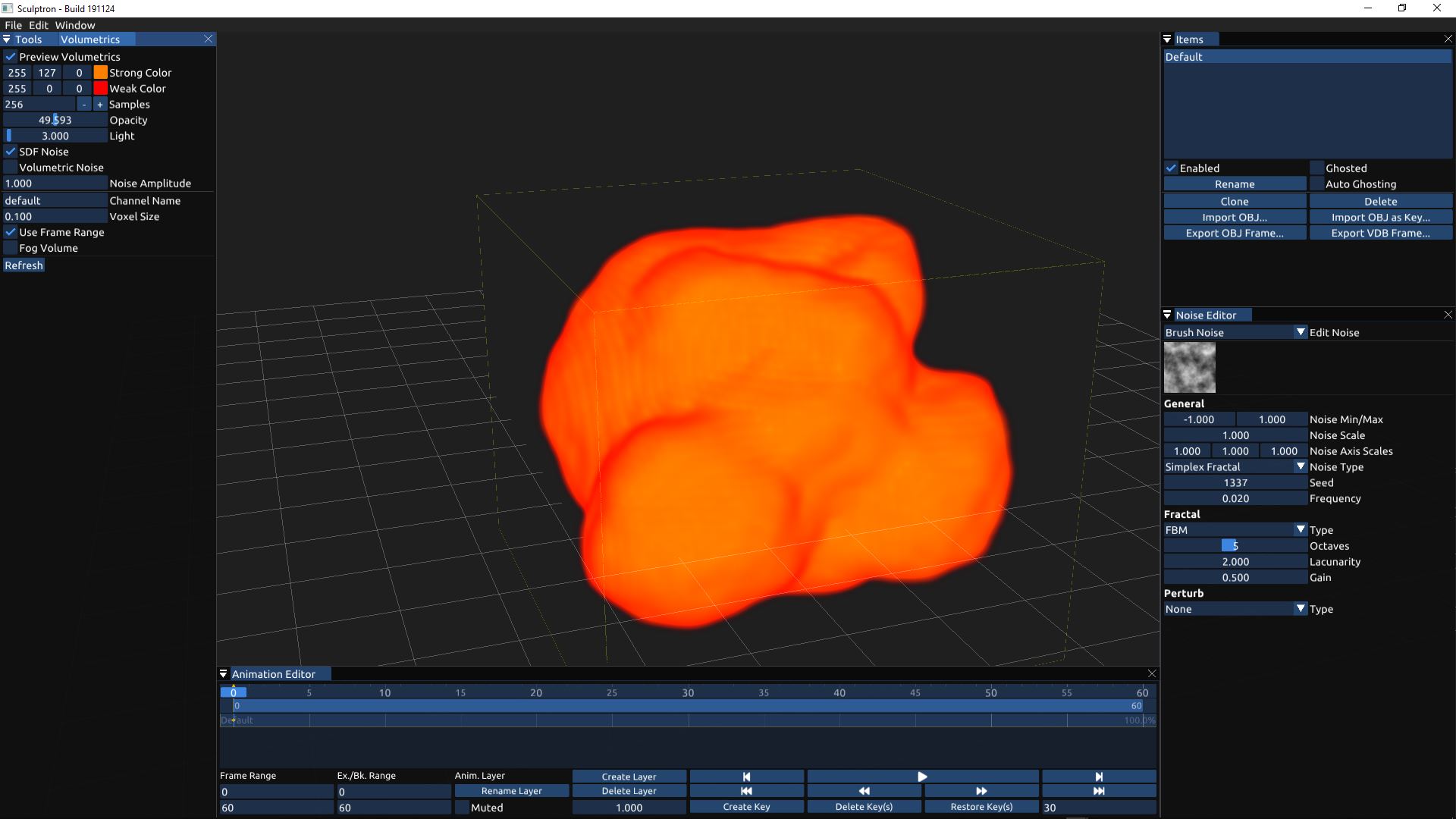

Any idea how to change voxel size ( number of voxels ) ? Voxel size change nothing... ?

HHbomb wrote:Any idea how to change voxel size ( number of voxels ) ? Voxel size change nothing... ?
I am trying to figure that out as well. When I bring a VDB sequence exported from Sculptron into Octane it appears very low res and pixelated.
Yes, the Voxel Size option defines the VDB resolution. You may have to use decimal values to get the result you need (0.1, 0.05...it really depends on the size of your mesh). Just remember to hit Refresh as you change the Voxel Size, so you can see the preview in OpenGL (not needed before export, internally the new value is applied anyway).
Changing the Opacity value can help better see the final result.

What does the parameter for samples control (default is set to 256)?
