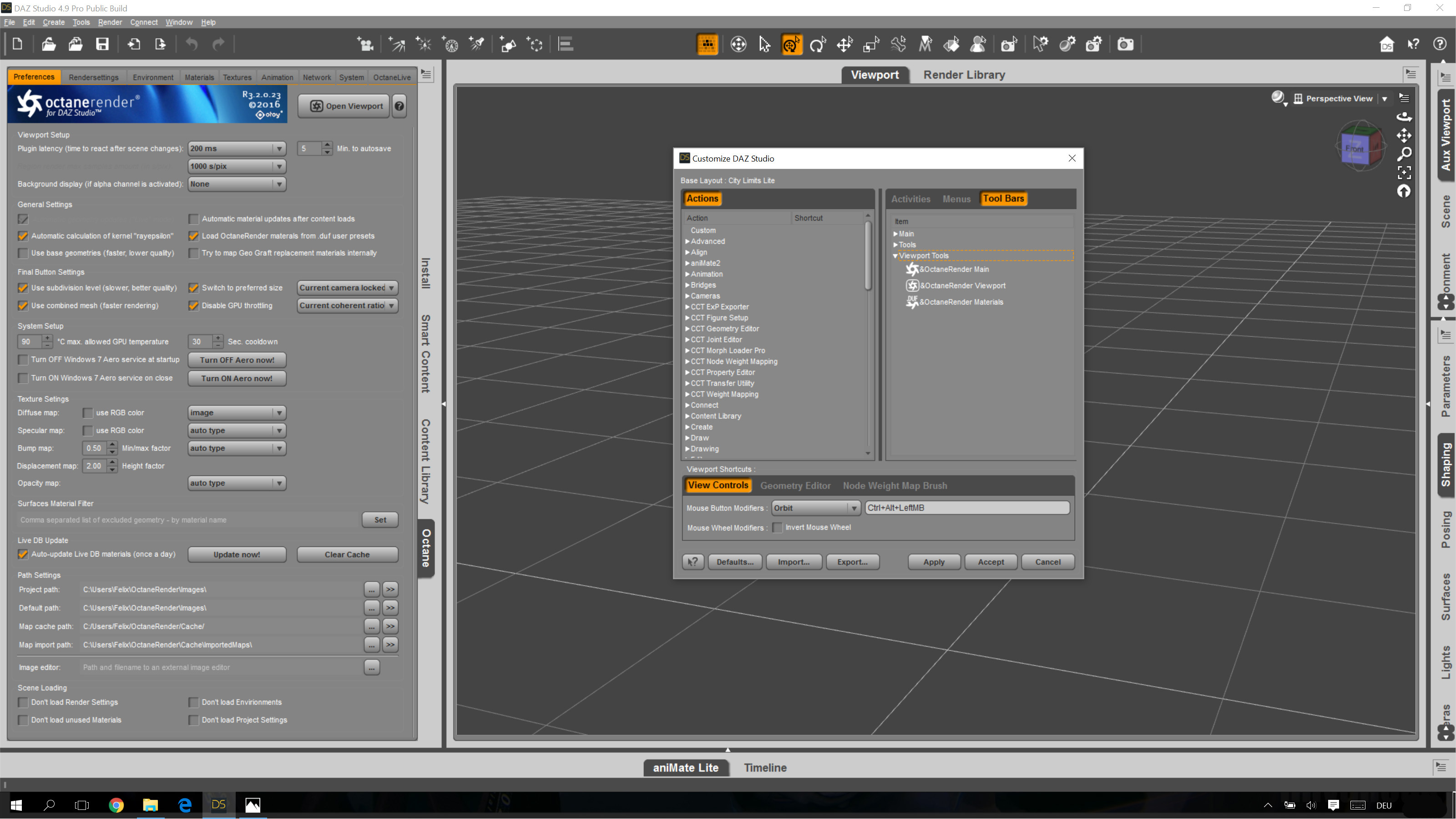

Just tried out how things look with the DAZ Studio 4.9 default UI on my laptop.
-> There is a chance that the Octane related actions are not displayed in the toolbars in some of the DAZ Studio layouts if the toolbar "Viewport Tools" is set to "Off".
To quickly fix this:
- Press F3 to open the "Customize DAZ Studio" window
- On the right pane select "Tool Bars"
- check if the Octane related actions can be found in the "Viewport Tools" tool bar
- On the right pane select "Activities" and check for each (!) activity if the "Viewport Tools" are toggled to On
-> With the "Viewport Tools" switched "On" all OctaneRender related actions now should be displayed in the upper right toolbar location.
Advanced options:
Similar to creating your own OctaneRender Main Menu you could also create your own tool bar and name it OctaneRender.
You may have to manually activate the toolbar in each activity in the "Customize DAZ Studio" menu as described above.
Speculation:
This limitation probably might have been the reason why the OctaneRender actions were added to the "Viewport Tools" tool bar.
-> The "Viewport Tools" tool bar was used in most DAZ Studio default layouts in the past.
