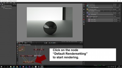

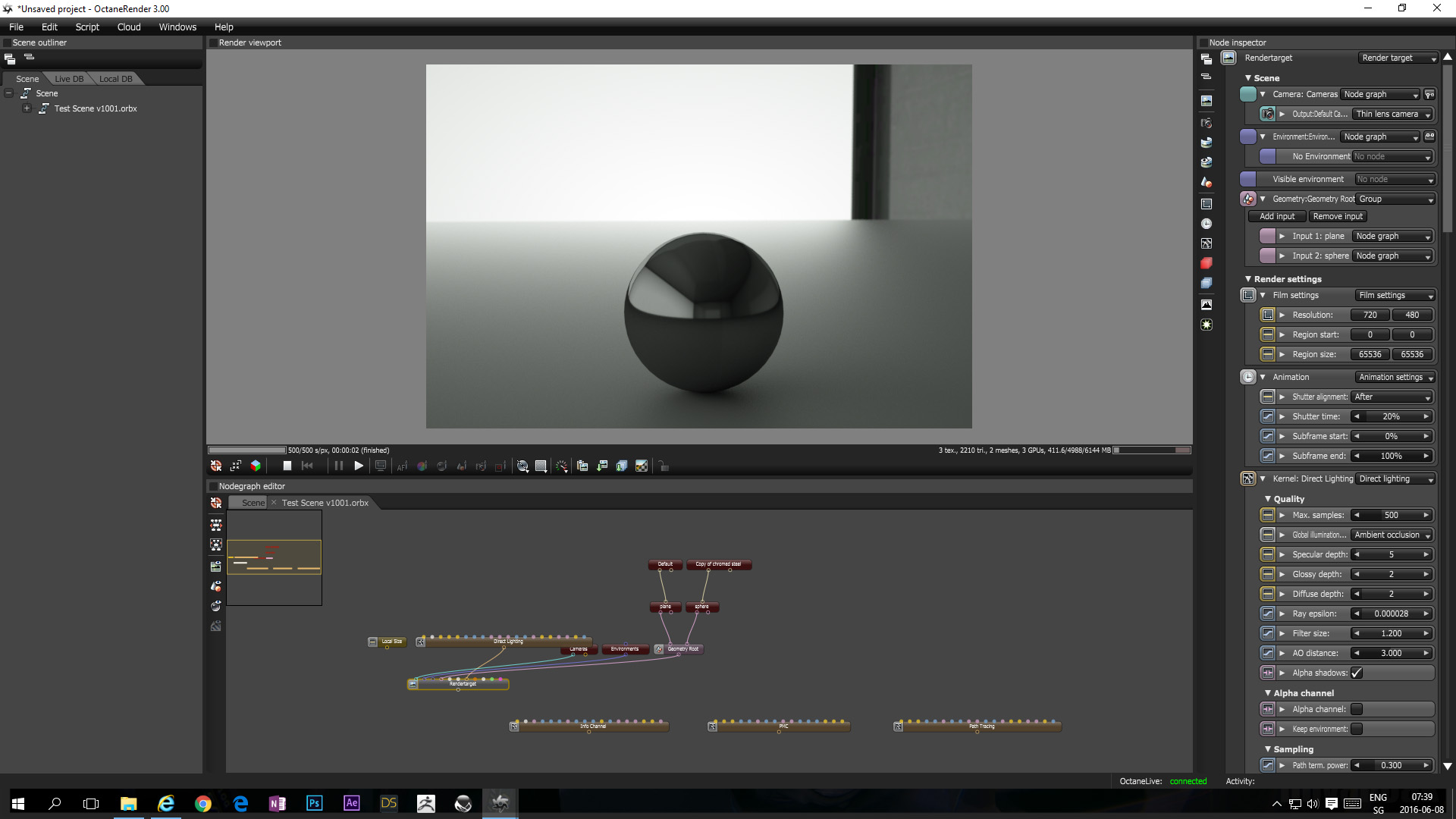

How do I find the render target node after exporting to OR standalone?
When you export from OcDS to OctaneRender standalone the "Render Target" node is located in a red group node called
"default Rendersetting"
or the name you gave your rendersetting in the OcDS rendersetting tab.
When exporting from OcDS to OR standalone the "default rendersetting" group node is located at the very bottom below all the geometry nodes.
The "default rendersetting" is most likely a red group node.
If you double click on it you will see all rendersettings you created in the OcDS rendersettings tab.
The render target node that is selected should be the last rendersetting that was used in OcDS.
You can also right click on the red group node "default rendersetting" to unpack it and see all of the included render target nodes in the main Node Graph Editor scene view.

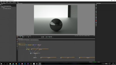

Why are all the imported nodes in OctaneRender standalone red group nodes?
When you export from OcDS to OctaneRender standalone it will not only export the current selected render settings, environments, cameras but also all other unused versions that are in the scene or in the pull down menus.
All those additional render settings, cameras, environments are grouped together in standalone as red group nodes.
- If you double click on a red group node it will open up a new tab in OctaneRender standalone node graph editor.
A new tab called "Default Rendersetting" was created
- If you ungroup a red group node all included nodes will be unpacked in the same node graph editor tab.
:idea: -> It may help to ungroup all red group nodes after importing in OctaneRender standalone to get an overview of all the imported OcDS render settings, cameras and environments.

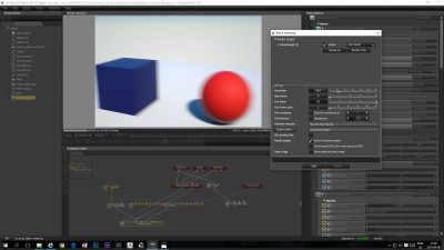

Where are the settings to start animation rendering in OctaneRender standalone?
Select
Script / Batch Rendering
to open up the Batch Rendering menu.
Make sure to set the output folder to match the path you would use in OcDS so you can find the rendered images.
You can find all the features of the Batch Rendering Script explained here:
https://docs.otoy.com/#60Batch%20Rendering

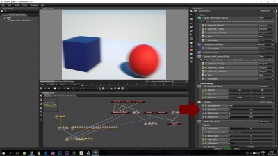

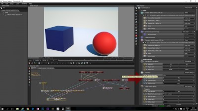

How do I adjust if there is motion blur in the animated sequence or not?
The shutter time settings that originally could be adjusted in the batch rendering script options have been moved to separate animations parameters in the render target node.
Adjust the Shutter time to the value of your preference.
Place it at 0 to turn off motion blur:

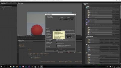

How do I properly set the file name in the batch rendering script?
At time of writing the manual section has not yet been updated with the latest changes:
In order to see the current options and meaning of the template parameters hover with your mouse over the Filename template field to make the yellow mouse over info box with the template parameters appear.
Per default the file name consists of a lot of information that you may not all want.
Especially if you leave the render target node unnamed you will end up with parentheses like (2) which may not work in video editing software.
For example, batch rendering an alembic scene with 80 frames and three render targets, a typical filename template would be %n_%f_%p.%e which will save rendered images as: <render target node name>_<file numbering>_<render pass name>.<file format extension>
%n_%f_%p.%e
If you want to use a simpler custom name use:
projectname_%F.%e
Just add your preferred file name instead of projectname.
%F will add the frame number with a 0 before it.
. adds the dot before the
%e = file extension
