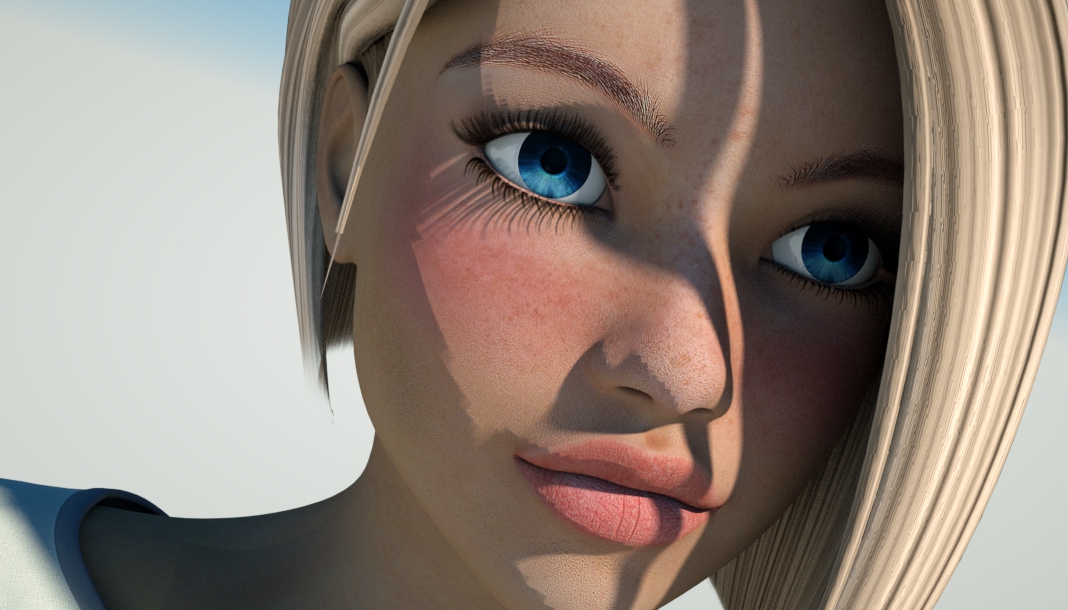

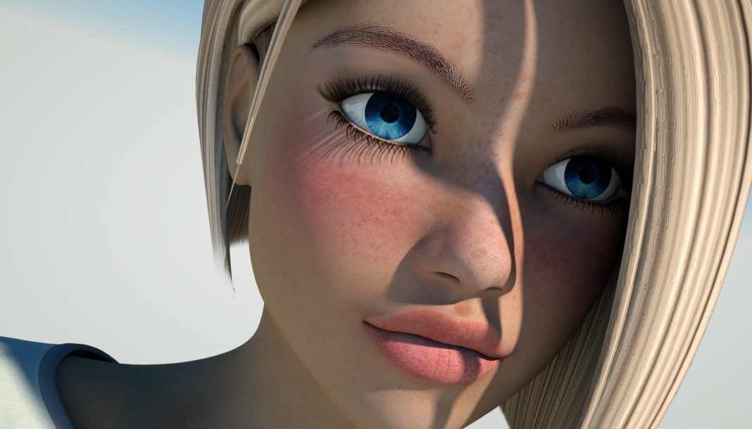

I too saw it and found the culprit. Material parameter for Normal is set to "2" by auto-material. Try slide it to 0.1. I don't really know the correct value for Normal.Notiusweb wrote:Hello! I am seeing a strange texture issue when rendering certain characters through the current OcDS plugin. Almost looks like a 'Cartoon Shader'
The following characters from L to R are Zahara 6, Mei Lin 6, Belle 6....Look at the difference in textures for the L and R models between each rendering utility (1) OcDS Plugin 2.23, vs (2) IRay, vs (3) Octane Render Standalone 2.23
(1) OcDS 2.23 (2) Daz 4.8 IRay (3) Octane Render Standalone 2.23
Interestingly, Mei Lin 6 (in the center) comes out clean in each render. But the other 2 on L and R look pixelated and toon-textured.
Sample rate same on each, I used default sun and sky environment on each...I did not tweak any texture settings between the 3.
To developer, or anyone, any ideas what may be causing this in the plugin...Thanks!

With the 'Normal Map' issue, does anyone know why the shadows, when Normal is 2 in these situations, are so pixelated? I am imagining it has something to do with the way the surface interacts with the environment lighting, because the shadow problem goes away in an HDR background scenario (ie the flat gray background). Might this also be related to pixelated shadows with mesh, or no.Postby kibbycabbit » Tue Jun 30, 2015 6:16 am
