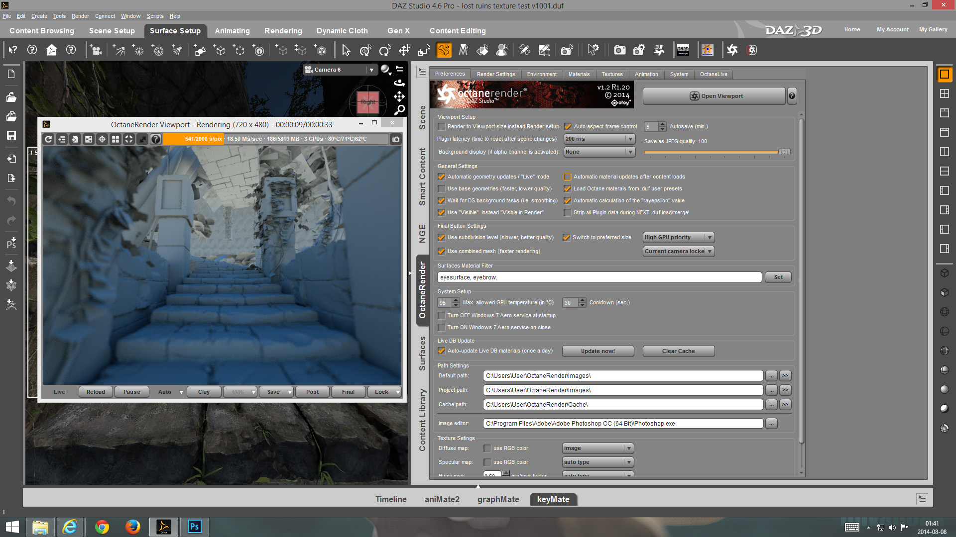

Which setting is controlling if DAZ Studio materials are loaded automatically and converted to OctaneRender materials?
In the OctaneRender plugin for DS Preferences Tab you find the option
"Automatic material updates after content loads"
If you remove this checkmark only the geometry and no textures are loaded when you open the OCDS viewport.
- When you open the OCDS viewport all the geometry will be displayed in a default gray material.
- This also means that whenever you change DAZ Studio materials those texture changes will not automatically be updated in the OCDS viewport. :!:
- If you change DAZ Studio materials while working on the scene you will need to reload them manually each time with any method explained below.
Automatic material updates after content loads - deactivated only loads geometry.jpg

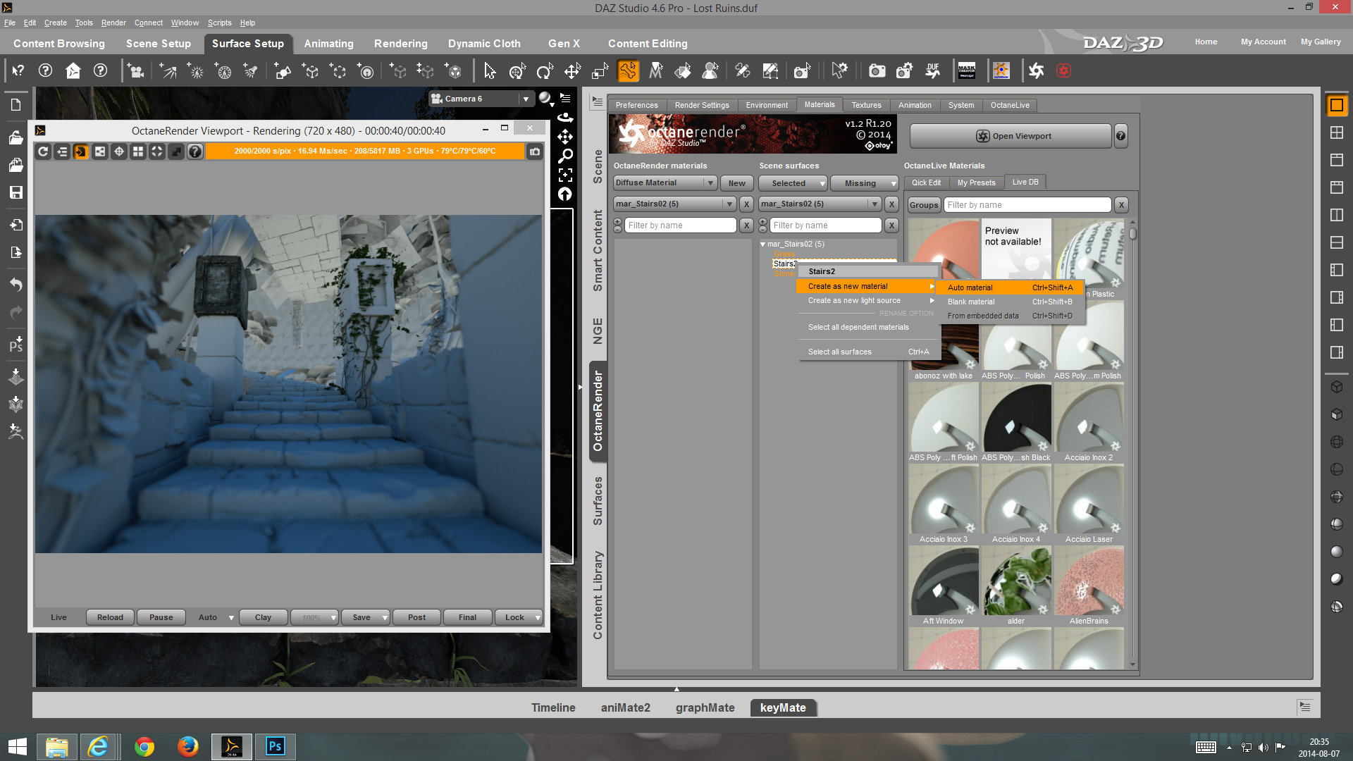

If you are opening the OCDS viewport for the first time on a new scene the surface names will be written in orange.
This means that no materials are yet assigned to that surface.
In the OCDS material tab right click on any surface and select "Create as new material - Auto Material" to reload the DS materials for that surface.
To manually load any DAZ materials of a surface and convert them into OctaneRender materials all you have to do is to right click on the surface and select
"Create as new material - Auto Material".

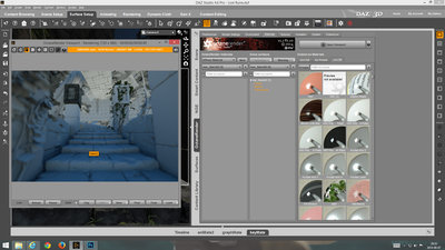

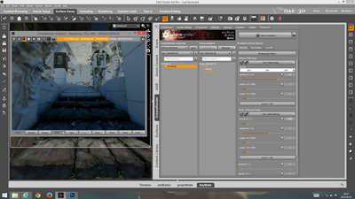

What does the automatic conversion from DAZ Studio to OctaneRender materials do?
The OctaneRender plugin will automatically load and convert any standard DS materials.
In most cases the plugin is able to detect if the DS material is a matte material and convert it to a OctaneRender "Diffuse" material or if it is a reflective material and convert it to a OctaneRender "Glossy" material.
If you quickly want to convert a "Diffuse" material to a "Glossy" material you can do that in the Node Graph Editor (NGE) by simply changing the type from "Diffuse" to "Glossy". Most maps will stay in the same slots but you will get the additional options that are exclusive to "Glossy" materials.
Because the native DAZ Studio render engine 3Delight uses a different node system than OctaneRender not all shaders can be converted. Any 3Delight exclusive shader setups will in most cases be converted to a much simpler basic material setup.
Especially Shaders with Subsurface Scattering (SSS) will most likely be transformed into a "Diffuse" material.
You will have to do additonal work to transform them manually into an OctaneRender "Specular" material with SSS.
If the conversion is successful you can immediately see the change in the OctaneRender for DS plugin viewport.
The surface Stairs2 is written in white in the Materials Tab Scene surface list to indicate that a material is now assigned to that surface.
Grass and StonesSmall are still written in orange because those surfaces have not yet an OctaneRender material assigned to them.

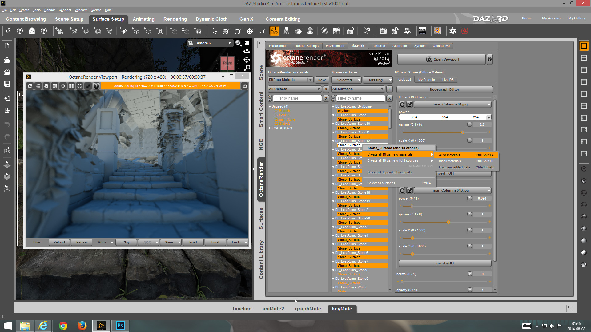

Use CTRL and SHIFT in combination with mouse clicks to select multiple surfaces at the same time to load them together.
As in most software you can use CTRL and SHIFT in combination with mouse clicks to make selections.
"Holding CTRL + left mouse button click" will add multiple surfaces to the current selection with each click. Click on the same surface again while holding CTRL to remove a surface from the selection.
"Holding SHIFT + left mouse click" will add all surfaces to the selection between the first and the last surface you clicked.
You can combine both methods to quickly create the selection of surfaces you want.
After you have selected those surfaces you want you can right click on the current selection and choose
"Create as new Material - Auto material"
All surfaces that are in your current selection are marked in orange with black writing.

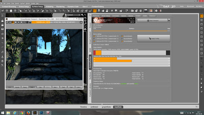

Use the OCDS System tab to get information about available VRAM space
In general while loading textures it may help to have a quick look at the available VRAM space in the OCDS system tab.

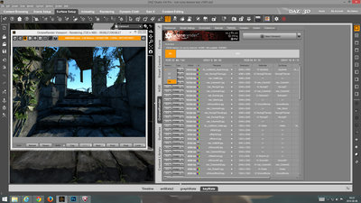

In the OCDS textures tab you can resize any textures to 1/2, 1/3, or 1/4 of their original size.
One of the most overlooked features may be to actually lower the size of the textures directly inside the OCDS texture tab. The feature may be hidden away on first glance.
Clicking on the first column "resize" in the OCDS textures tab will open a pulldown menu.
The texture can be resized to 1/2, 1/3 or 1/4 and will take less space in the VRAM.
The original texture size is not lost and can be quickly restored by selecting the default size of 1 again.
Use the resize function on the OCDS textures tab to lower the amount of VRAM used.jpg

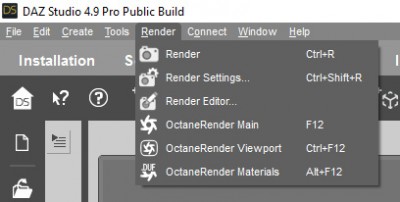

Assuming you don't have the icons on your main bar, you can go to Render>OctaneRender Materials and set that to manual. Should load only the geometry. If you do have the icons, just click the Octane one with auto or .duf over it until it says man. if that doesn't work, I'm not sure what's wrong, since that's how I troubleshoot mats that causes crashes, and it always functions correctly for me, regardless of what the system tab says.
Edit: I clearly don't pay enough attention to the preferences tab, as all that changes is also unchecking the box for "Load Octane materials from .duf user presets." Apparently, this setting loads mats saved with the .duf, even if auto loading is off. I presume this means that auto is only for conversion of mats, and doesn't apply to saved mats. Sorry if you already tried this and I missed it.

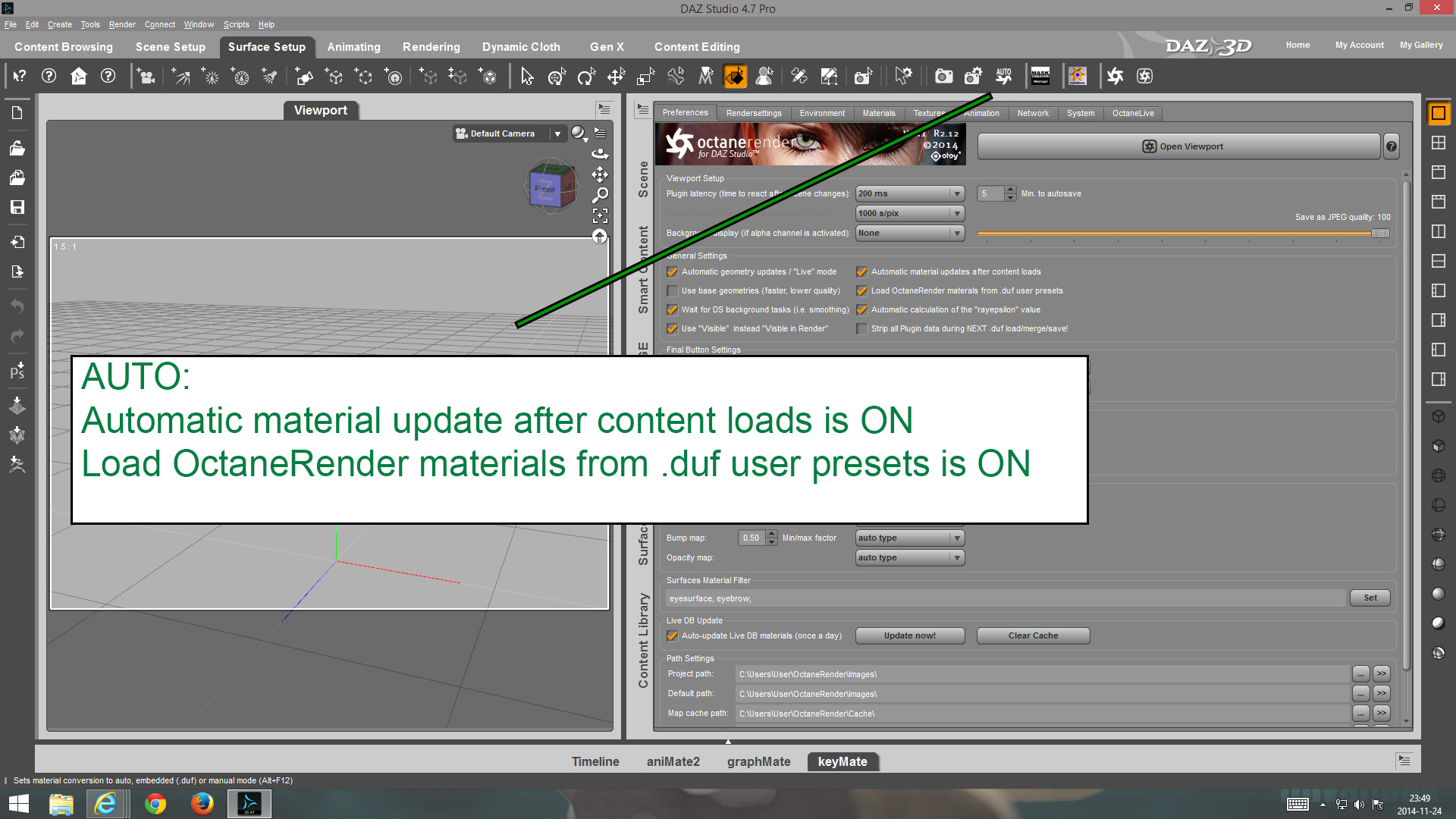

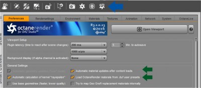

The material conversion states AUTO, DUF, MAN
AUTO
"Automatic material updates when content loads" - ON
"Load OctaneRender materials from .duf user presets" - ON
This is a useful setting if you do want to fully rely on the material auto conversion of the plugin and have enough VRAM to handle even large scenes.
In auto mode any Iray or 3Delight DAZ Studio materials are converted the moment you load a new object into the scene.

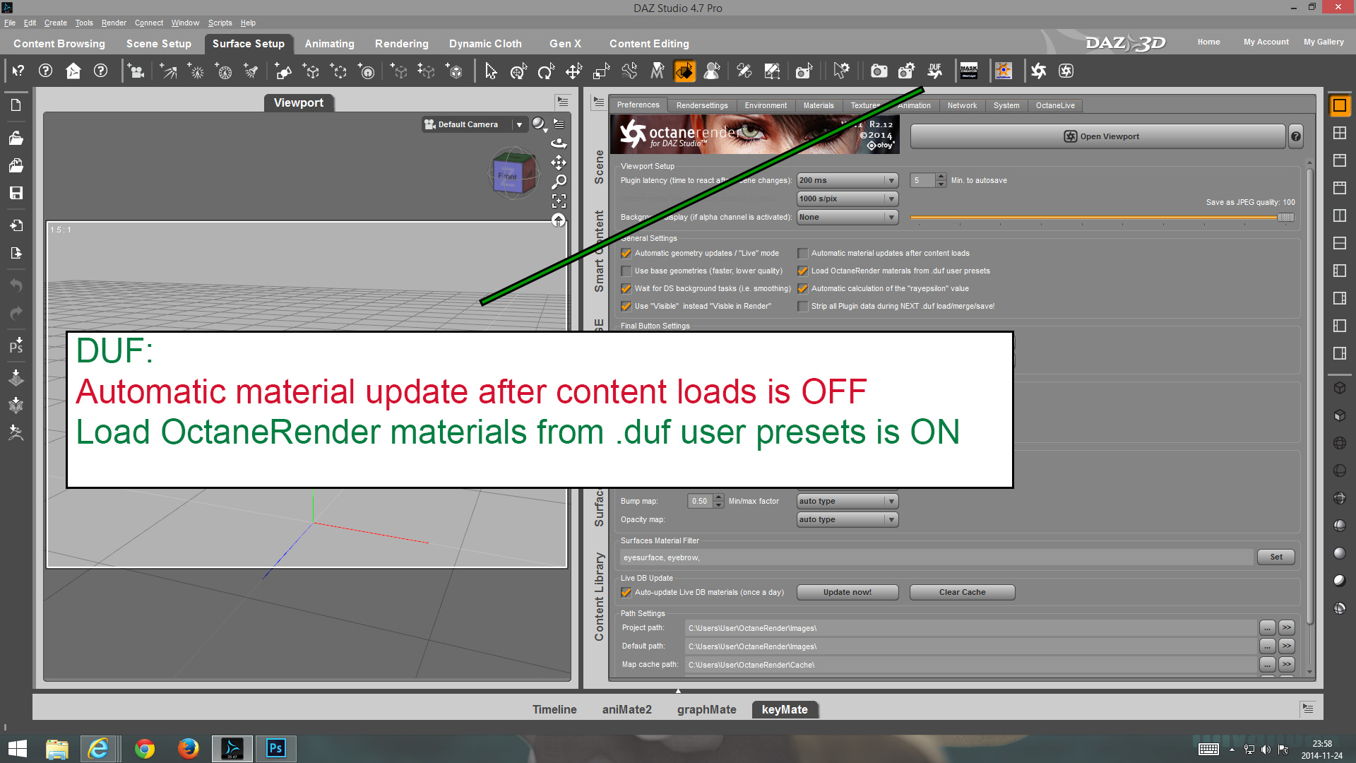

DUF
"Automatic material updates when content loads" - OFF
This setting is useful if you have limited VRAM and want to only load the geometry of new objects added to the scene.
The basic idea is to manually load the materials of one scene object after the other with the help of the tools described on the first page of this thread.
Scenes with objects that already have OctaneRender materials set up do load with the materials.

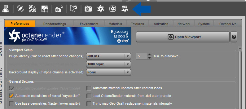

3 Ways to toggle between AUTO, DUF, MAN
There currently are three ways to toggle between the three states AUTO, DUF, MAN
- In the OctaneRender plugin for DAZ Studio preferences tab you can add and remove checkmarks for "Automatic material updates when content loads" and "Load OctaneRender materials from .duf user presets" manually.
- In the DAZ Studio user interface tool bar the current state should be displayed as a button that switches between the three stages when clicked.
The button is only displayed when the tool bar "Viewport tools" is toggled on for the current activity in the "Customize DAZ Studio" window. F3.

- In the DAZ Studio user interface "Render" main menu the option to switch between the three states can be found as action called "OctaneRender materials".
