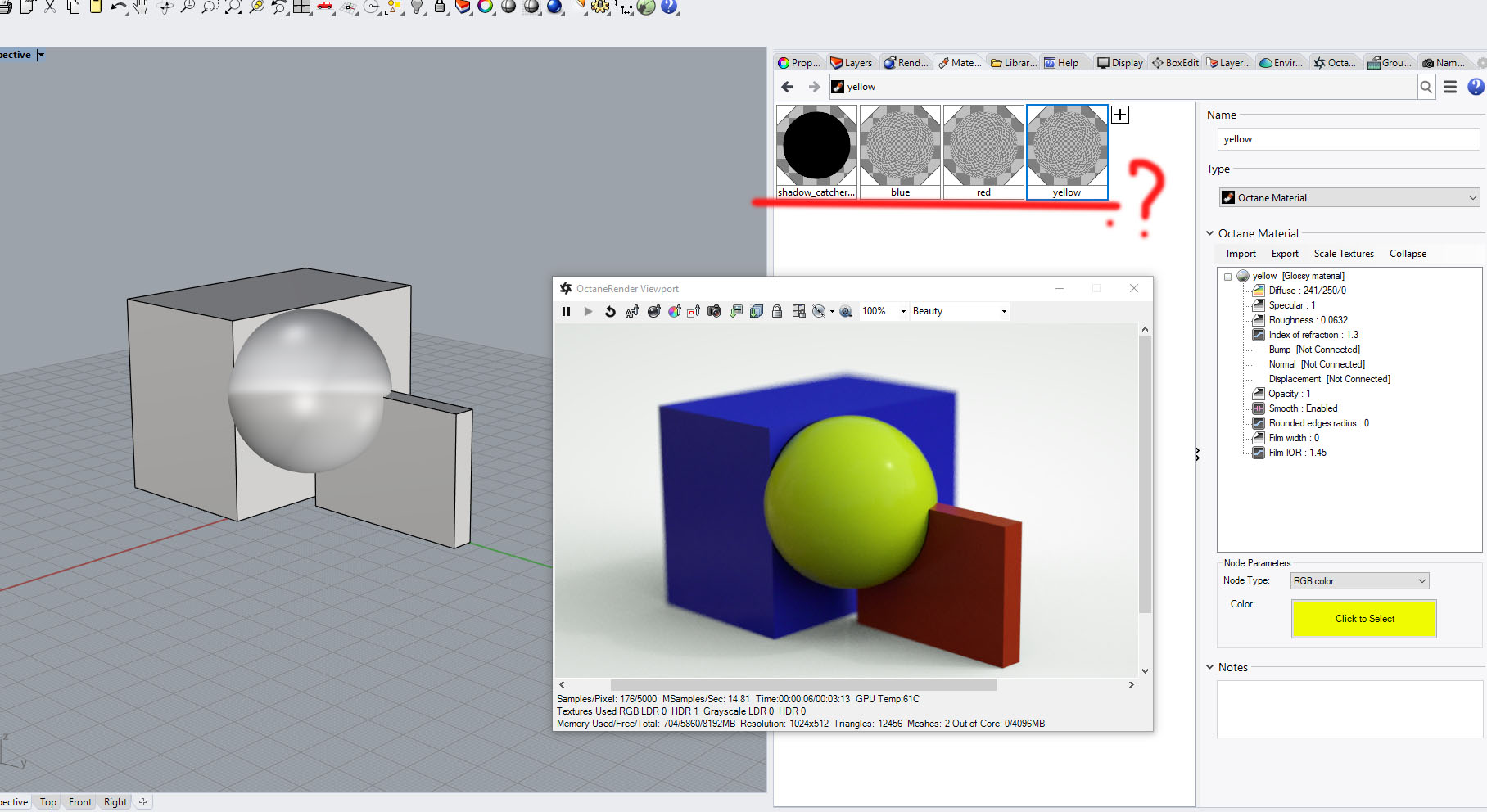

Paul, not sure if its rhino issue or octane plugin, but my material preview thumbnails doesnt look right.
Rhino 6 WIP , octane plugin build posted 3 posts earlier.
I have reported the thumbnail preview issue with Rhino6 to McNeel and they are investigating.
