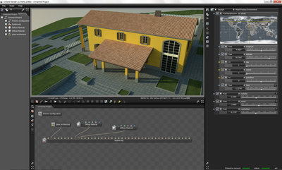

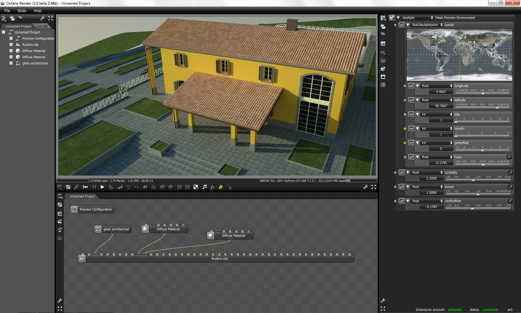

You end up with this:
Saving the above to cubes.mtl and importing in Octane, we now get this:# Rhino
