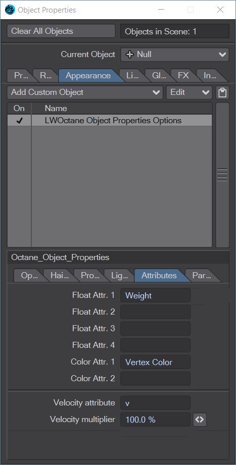

Postby juanjgon » Wed Nov 11, 2020 6:14 pm
juanjgon Wed Nov 11, 2020 6:14 pm
You can configure the vertex map names in the Octane object properties options.
