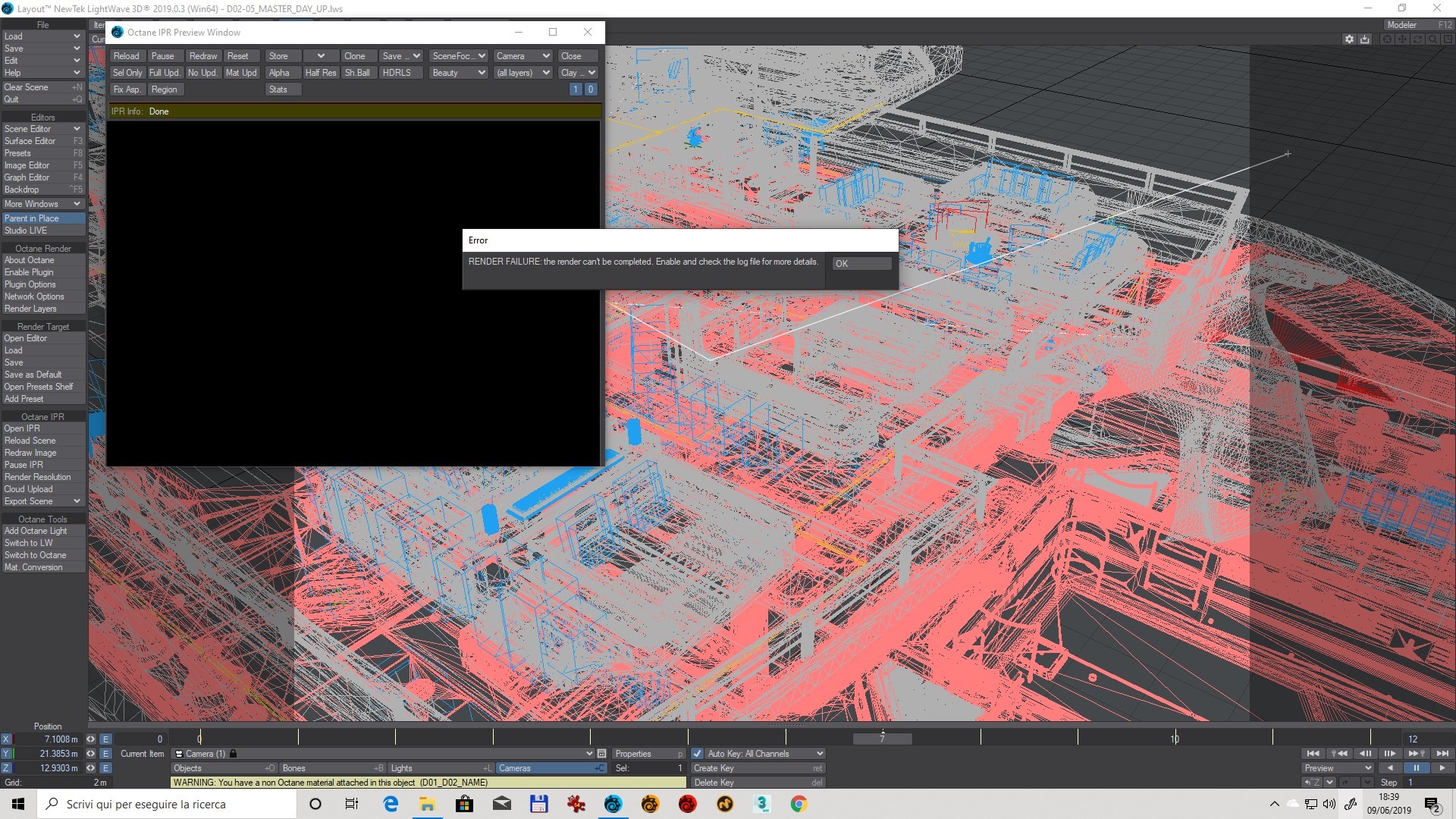

I also have a new issue that I have never seen before...
Its an old scene that worked fine before installing 4.04 (before it was 4) and a fresh install of windows 10...

Postby spigolo » Sun Jun 09, 2019 5:03 pm
spigolo Sun Jun 09, 2019 5:03 pm
Ok enabling out of core fixed this latest issue...
