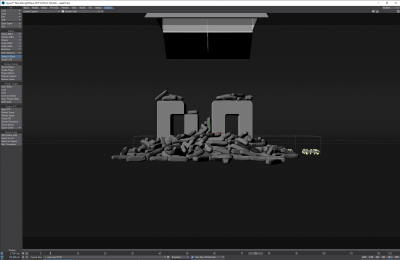

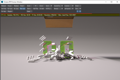

Hi¡ im doing a bullet dynamic animation, i have an objects and i set it to parts in bulletD i see the simulation fine in the layout but not the same in the IPR, is there a method to get righ results?

Well, i was wrong again, i just uncheck the instance clone in Render Target node.
juanjgon
Posts: 8867
Location: Spain
Yes, usually all these problems come from this feature. The instances must share the same base mesh, so if you instance LW clones that have deformations, all the clones are going to be rendered with the same shape in Octane.
