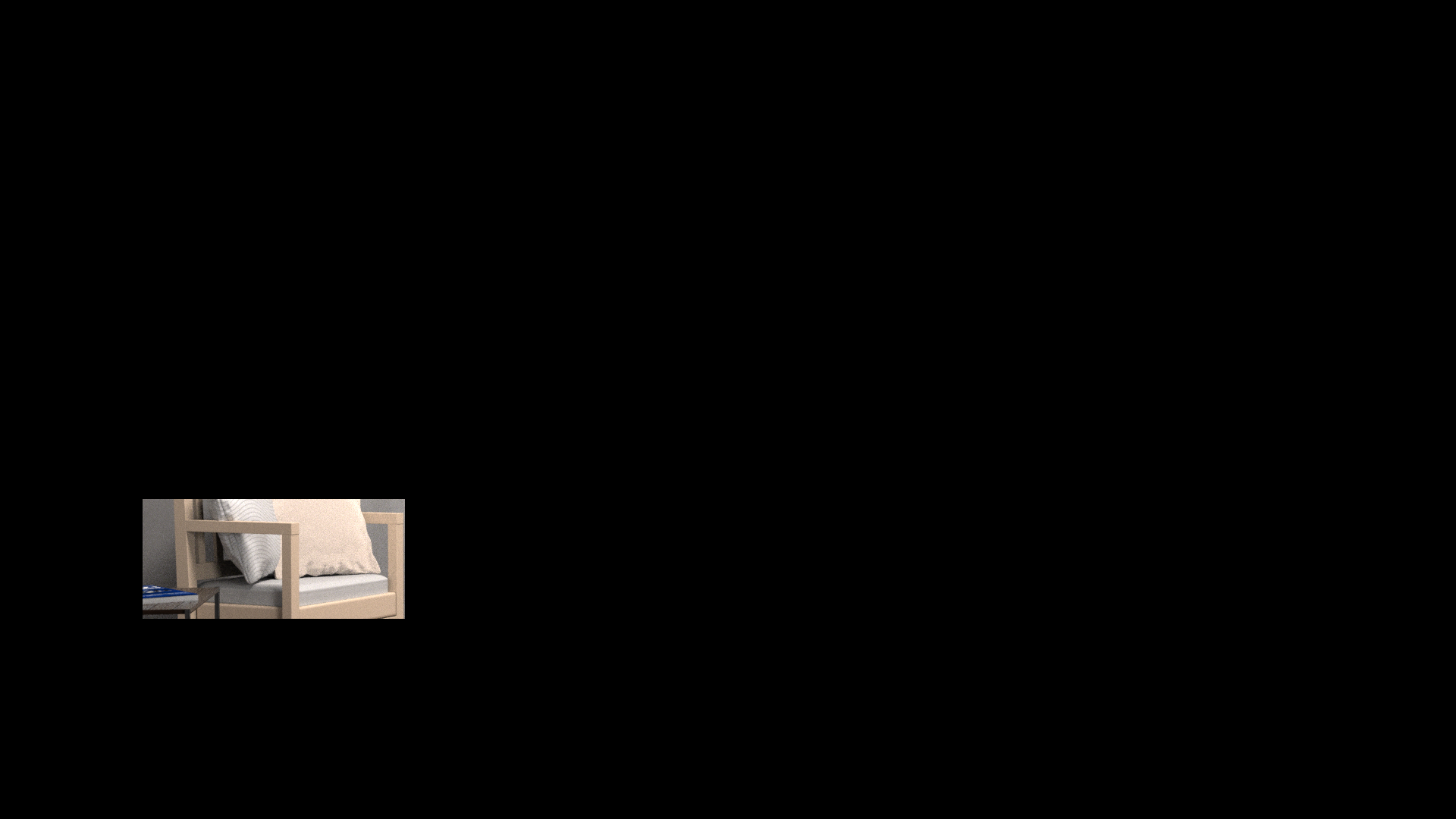

Hi¡ im using the lightwave render region to render a small texture change in one scene of Octane , with DirectLight kernel, but the denoiser seems to fail to render in render region, all my scene have static noise except when i use render region. is this a limitation, or can be fixed someway?

Yes, sorry. I'm afraid that the denoiser is not compatible with the render region feature, as far as I know.
