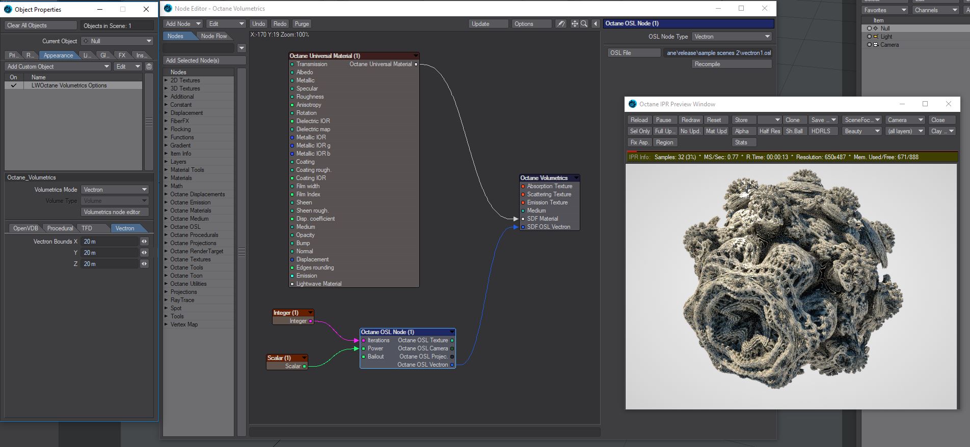

LightwaveGuru wrote: :) Thanks Juanjo. Do you have some tipps or links to create that mandelbrot.osl you use for your test?
This is an example scene with the Vectron feature. As you can see, this feature in the LightWave plugin works from the Volumetrics custom object panel, linking an OSL node configured in vectron mode to the new input available in the volumetrics node editor.
Thanks,
-Juanjo
Thanks,
-Juanjo
yes i know that with the volumetric panel...my question was why i build my own .osl shader code. but...thanks for your example :) i love it :)
