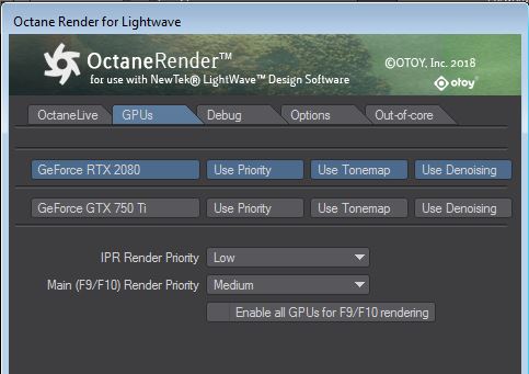

in my computer there is a RTX 2080, that I use only for the rendering, and a GTX 750Ti, that I don't use for rendering but only to work (OGL and so on), so I can continue to work in LW and in the same time render the scenes, one after the other, when they are ready.
To do this I use the screamernet for the rendering.
The problem is that the screamernet renders on both the GPUs, but I want it uses only the 2080.
There is a way to force SN to don't use the 750ti?
In the image you can see my settings in the renderer options
Thankyou for the help
Screamernet use both GPUs

To configure the render nodes for LWSN you need to add a plain text config file with the name octane_node.cfg to the C:\ disk of each render node. This config file have some basic information about the Octane configuration, and it must have the next format:
For example, this is the config file to enable the out-of-core with 8 GB of RAM available and a GPU head room of 300 MB, enabling only the first GPU in a system with two GPUs:
Hope it helps,
-Juanjo

Really thankyou Juanjo! It works now!
To work right I changed about the GPU enabled
1
0
0
0
and not only
1
0
With only 2 lines screamernet writes only
GPU0 set in 1 state
but nothing about GPU1... I think (screamernet?) doesn't read the first 0 (after the 1) ... so now with 4 numbers it writes
GPU0 set in 1 state
GPU1 set in 0 state
GPU2 set in 0 state
I haven't the GPU2, so no matter write or don't write it, but very good now screamernet writes GPU1 set in 0 state (and only the RTX2080 renders the frames).
Again thankyou and have a good night.
Gianluca
