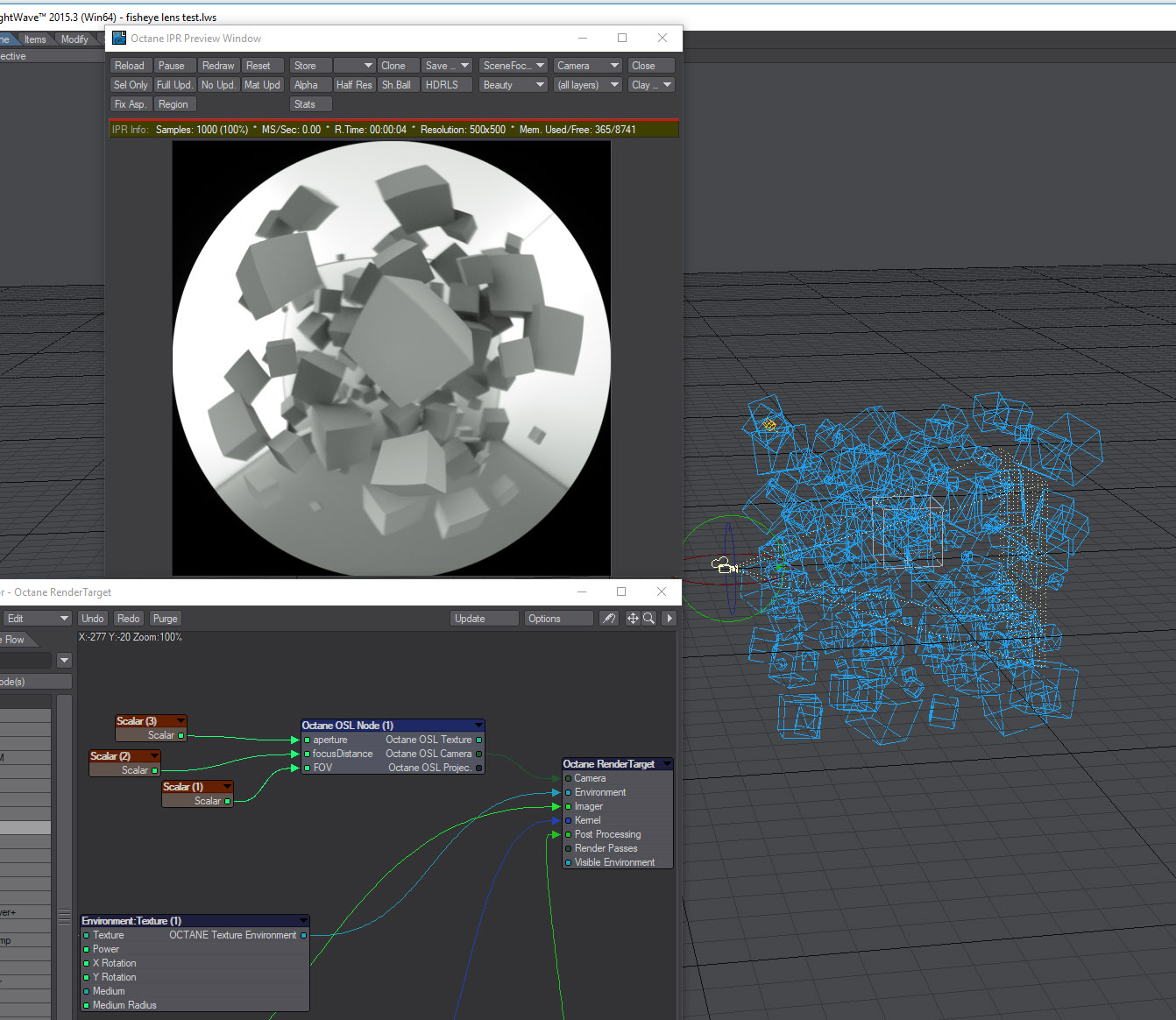

For anyone that likes funky lenses, here's a quick implementation of a fisheye lens I've written in OSL.
It defaults to a FOV of 180 degrees, an aperture of 1 unit and a focal distance of 5 units. These can be overwritten in the node editor by connecting scalar nodes to those inputs...

What's the appeal of anamorphic lenses? I think the main visual effect is that a wide image is squeezed onto a narrower negative. When this is then stretched back out during projection any optical effects that happen within the lens are stretched too; bokeh and lens flairs become stretched horizontally. I think this is conceptually the same as having an elliptical aperture in the camera. Is that what you're trying to create? Fairly straight forward in OSL.

Hi!
I'm currently doing RnD for a project, and I stumbled upon this great OSL camera.
However, we'd need full-frame coverage. Is there a way to modify this so that we can crop the image directly in the script and avoid the black parts?
(we don't want to render double resolution and then crop out the area to display)

That's straight forward enough... Here's an updated camera with a pin for cropping. It defaults to not cropped, but you can make it crop by attaching an integer of value 1 to this input.
I've set it up so that we reach full field of view at the mid points of the edge of frame. This means the bits that are now no longer cropped are wider than the FOV of the camera. In short, it's quite likely that the corners of the image will show points behind the camera...
I've also tidied up the DOF calculations, so it's worth switching to v2 of the camera even if people don't want the crop/uncrop functionality.

To maybe save somebody a bit of messing around, I've found that a FOV of 127.5 degrees with a standard 16:9 aspect ratio will give you the max fishiness without rendering anything that would actually be behind the camera. I think that's what you'd actually see if you cropped a real world 180 fisheye image. It's simple enough to test this for whatever aspect ratio you need by placing an appropriately obvious textured test plane right behind the camera and perpendicular to the line of sight.
