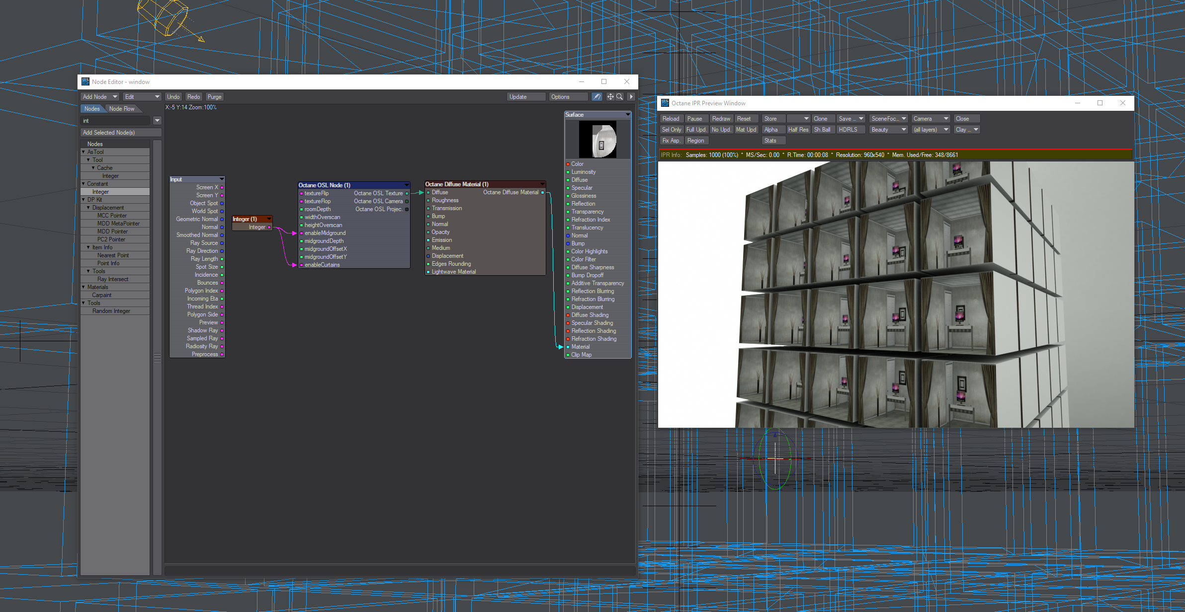

Hi all,
I've had a bit of a hack at the code and got it working at my end. I'm hardcoding the texture into the OSL file, so you'll need to correct for your own file location. If you're on windows then make sure you use forward slashes in the path as shown. I've also had to tweak the co-ordinate system and modify the boolean pins to integers. All credit to Julius Ihle for making it in the first place!
Cheers,
James

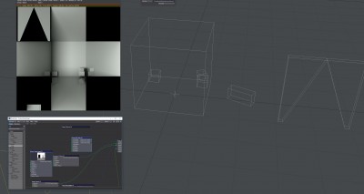

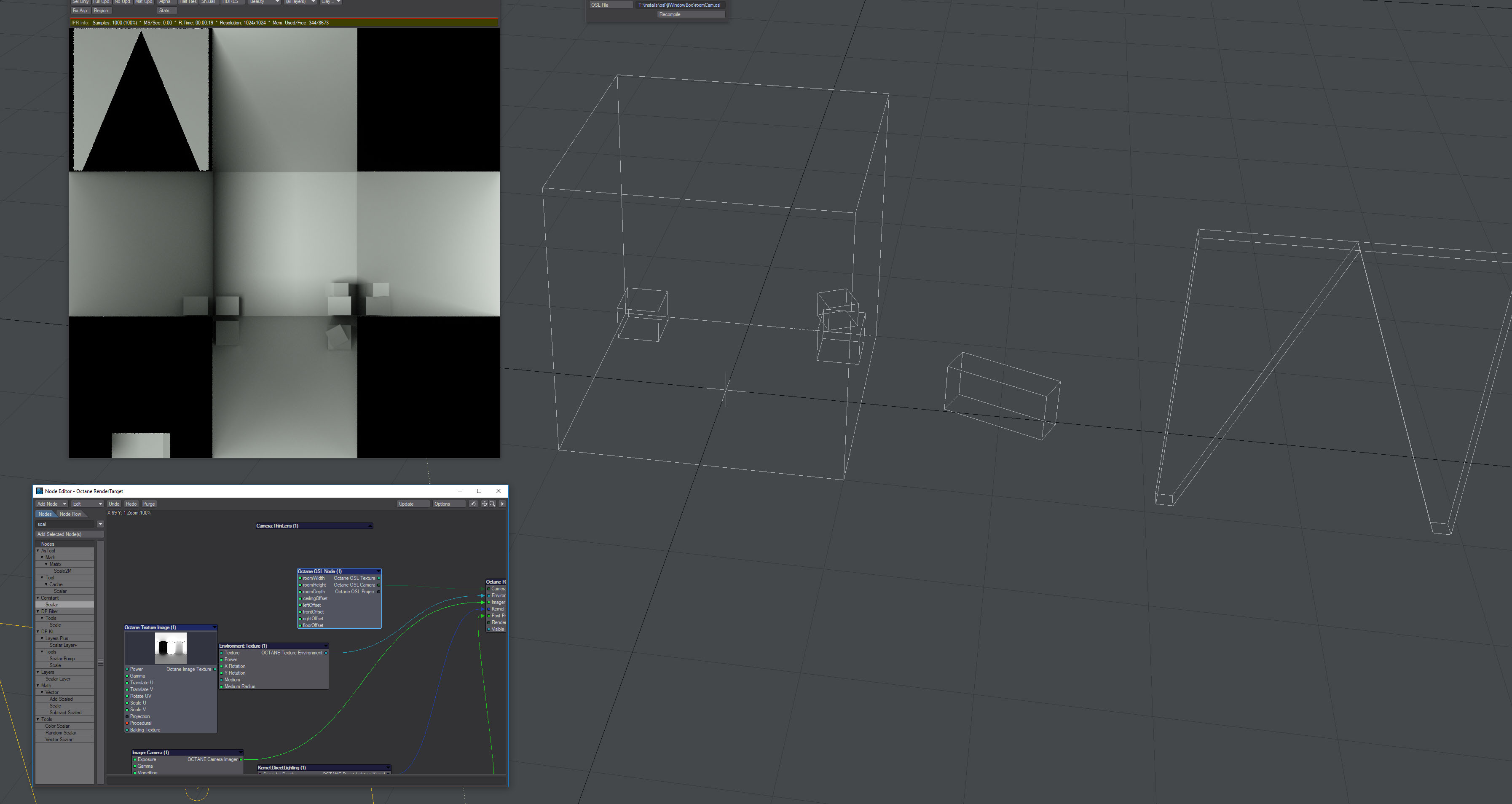

Here's an OSL camera that might do the trick...
It renders out 5 internal isometric isometric views of a room in a cross shape. In addition, the bottom left corner renders out a view offset to the right by one room width (place your midground objects here) and the top left corner renders out a view offset to the right by two room widths (place your curtain objects here)....
The offsets let you shift how close to the walls things get rendered from to avoid objects appearing in multiple views.
Make sure your room objects rest on the ground plan and are centered left/right and forward/backwards.
It's very messy and comes with no guarantees!
Good luck!
J.
Good luck!
J.
