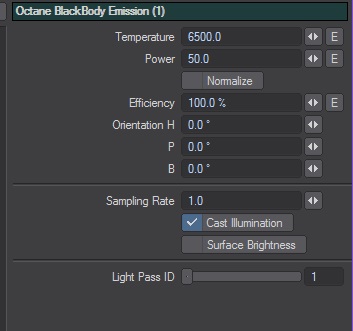

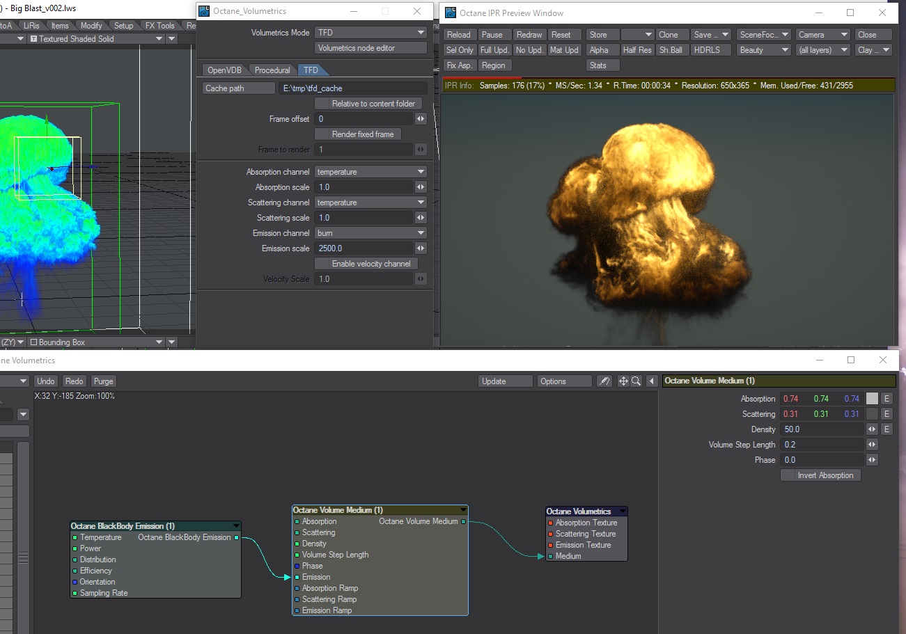

This is the basic configuration that I use for the blast demo scene, including the black body emission setup.
Hope this helps,
-Juanjo

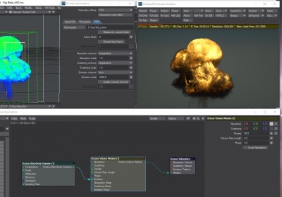

Hey Juanjo- I appreciate your responce but entering these values does not yield the same image for me here. Was this example made using the latest Octane build and the latest TFD (1425)? I am really struggling with the workflow and starting point for values in the pipeline. Are you working on more complete documentation and example scenes in the near future? Sorry to bug you... I have used Fumefx for years but I am hoping to use a tfd/Octane solution for some quick turnaround r&d work. I have seen exactly what I need in your renders of fire, but really struggling to reproduce it here.
Thanks for your time-
Cheers
/r

This is the scene. Probably you are going to need to change the cache path in the TFD container and the Octane volumetrics options panel, but it should work fine. Yes, I'm using the latest plugin build.
If the scene doesn't work on your system, please let me know.
Thanks,
-Juanjo
