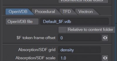

Do you mean - rename this files or another option? Where should I paste this value - "Default_$F.vdb"?
Thanks.

promity wrote:Do you mean - rename this files or another option? Where should I paste this value - "Default_$F.vdb"?
Thanks.
In the filename. Put this expression in the OpenVDB file parameter and the plugin will replace the $F token by the current frame. BTW. there is an additional parameter to set a frame offset for this token.
