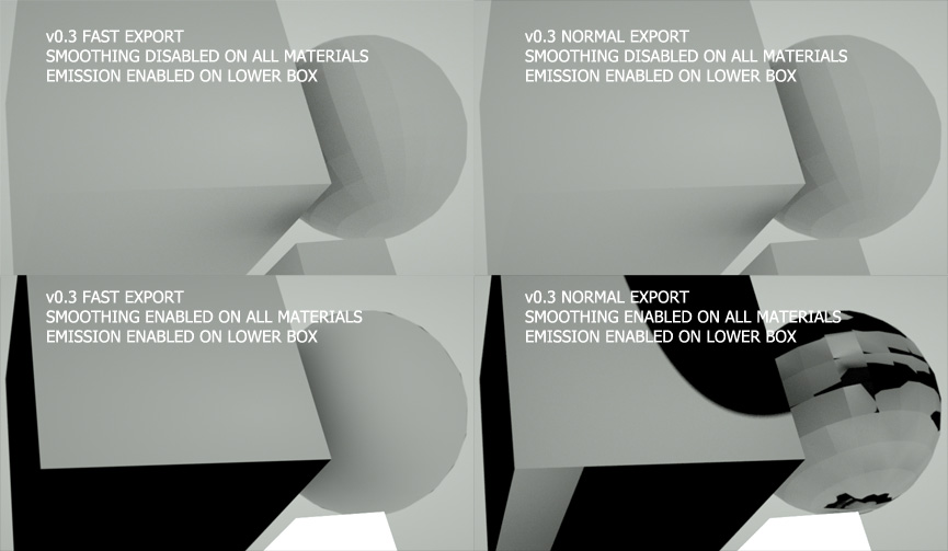

And here is the same scene with v0.3. Note that the emitter never actually emits any light even though it looks bright white with smoothing enabled (this is because the polygons are flipped... fixed in v0.4)
So by the looks of it v0.3 with fast gets the smoothing almost correct (we could probably just disable smoothing on the big box anyway).
Right now the best solution is to use v0.3 but FLIP all your polygons (or at least the emitters) in modeler before you export.
