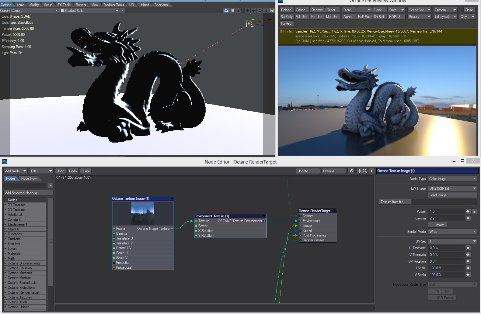

But if you are lighting the scene with an HDRI texture, why are you using the daylight environment node?, to have a direct sun light in the scene? ... what I was thinking is to use a real life skylight HDRI texture environment map (perhaps with the sun removed with a paint program if you don't want to see it), and use an Octane light to simulate the sun direct light.aeolian001 wrote:I am using an HDRI texture for the environment. However the animation "camera moves in the panoramic animation" is over 1500 frames.. taking out the octane sun with paint for 1500 frames? whew that's a job!
Something like this setup, a sunless HDRI environment and a Octane light unseen by camera to simulate the sun light. This is a daylight lighting with an invisible sun
