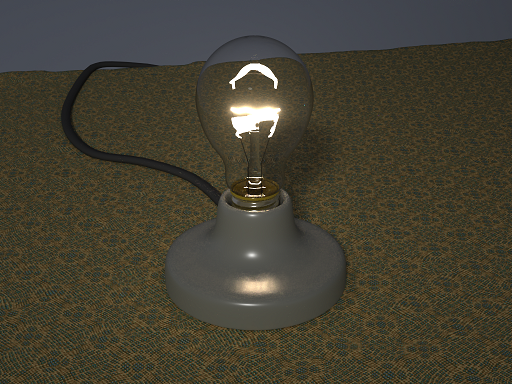

Of course window glass is very different from lightbulb but a while ago I modeled an old-style lightbulb and even for that I used thick object (thickness about 0.3mm) and the result was quite amazing

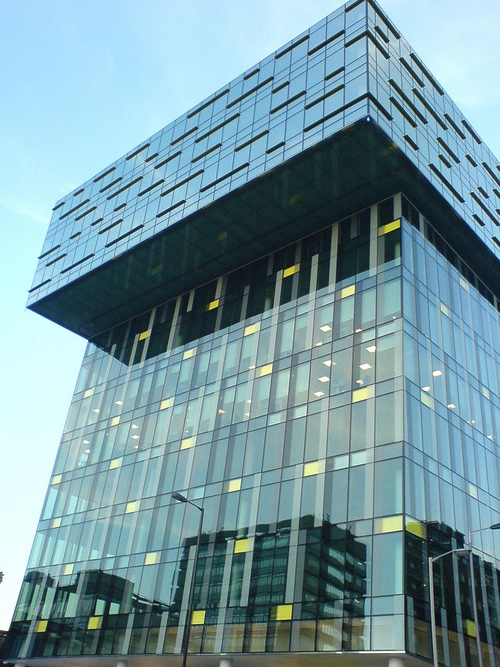

But basically glass in general when on a building will reflect almost like a mirror at harsh angles...60+ degrees or so. I'm not getting that by default with the specular material. I have to use the Glossy material with a falloff node and adjust the opacity manually. Which I don't mind at all....just wanted others feedback as I'm new to Octane in Lightwave.

You might find something here http://3dxyz.pro/category/octane-render/3dreamstudios wrote:this is a quick google search as to what I think I should see.... You can see on the bottom portions where we are looking more straight on to the glass you can see through it more....the highest portions is almost a pure mirror....
