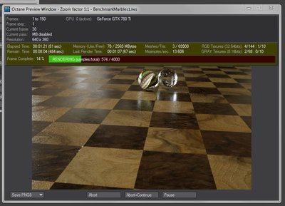

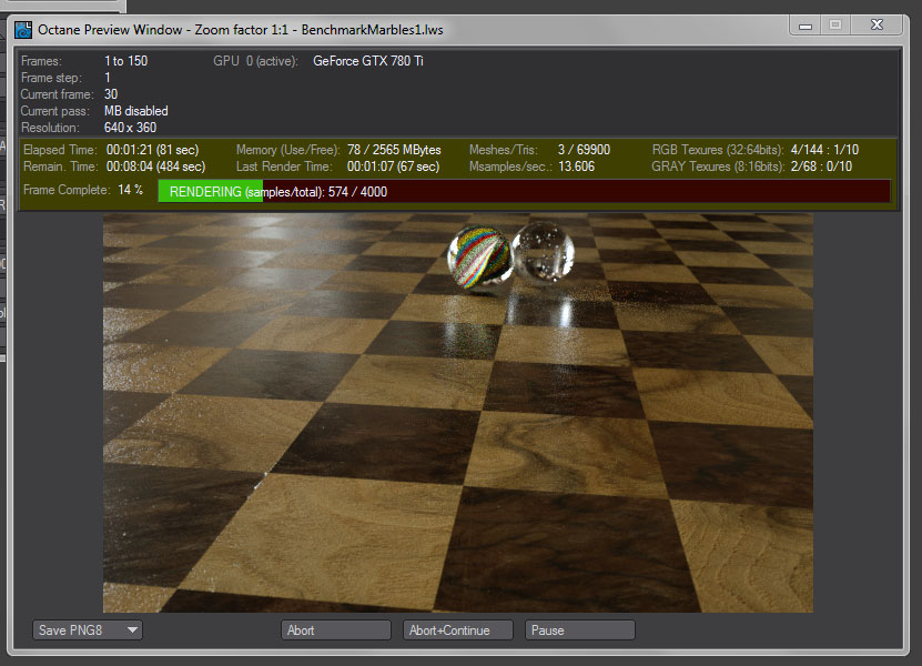

and here is the screen grab.

You have the same problem as using Standalone:
00:31:48 (1908.19) * OCTANE API MSG: CUDA error 715 on device 0: Error code unknown.
00:31:48 (1908.19) * OCTANE API MSG: -> Kernel execution failed (pt)
00:31:48 (1908.19) * OCTANE API MSG: CUDA device 0: Path tracing failed
I think that your system has a hardware problem, perhaps the GPU or the PSU ... can you test your card in other computer?
-Juanjo
