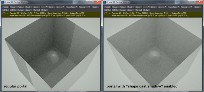

I just noticed Octane lights set to portal are not working correctly. Light from the environment texture is not passing through them (as if they casting shadow). I had a room where all windows were covered by portals and very little light was getting in. If I use geometry and apply a portal material to it, it works fine.
I think I found a workaround until it's fixed:
1. Change the light type to something other than portal
2. Check "shape cast shadow"
3. Switch the light type back to portal
The portal stops casting a shadow

Cast shadow is disabled by default as you said. With the portals, I have to actually ENABLE it for light to pass through them, so something funny is going on.
Here is a simple scene that has a portal sitting in the middle of some geometry. You can see half the geometry is darker than the other because the portal seems to be blocking light. If you change the light type and ENABLE "shape cast shadow", then go back to portal light type, the scene looks fine.
portal_test.zip
(12.96 KiB) Downloaded 332 times

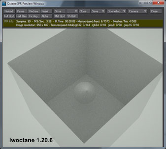

Just to be sure, I installed 1.20.6 again and rendered the same scene. The portal works fine.
It seems this bug was introduced in 1.23.2
