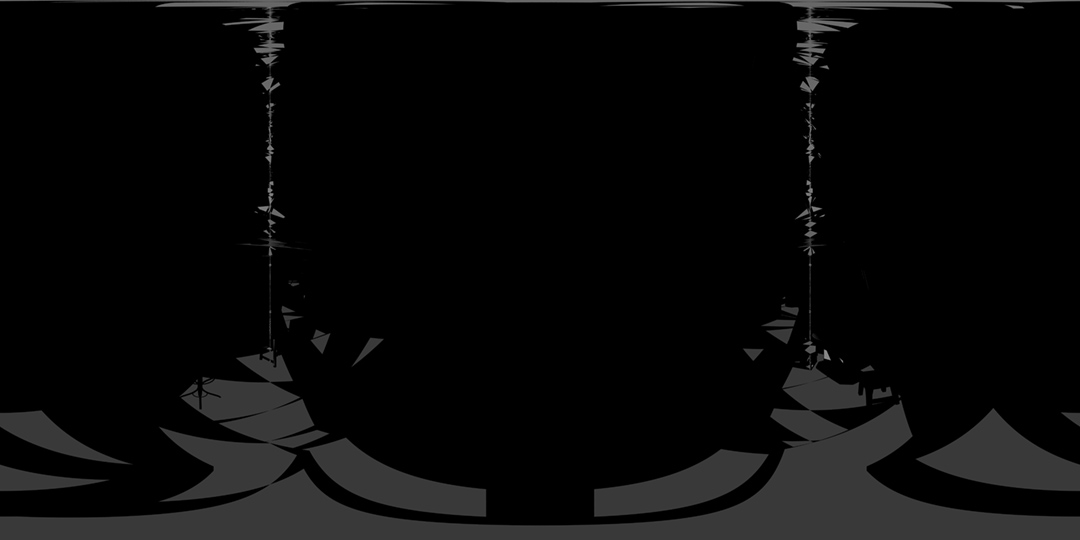

When I try rendering out a quick 360 panorama of a scene using wireframes I get a rather black final image with a few polygons showing up around the 90 degree mark. This is a very large render 7200x3600

The wireframe kernel only works correctly with thinlens and orthographic cameras. I will add supporting other camera types to our TODO list.
