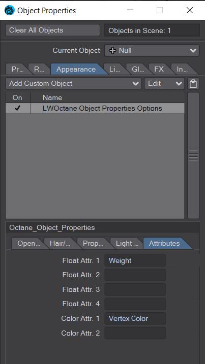

Hi Juanjo.
Can you tell me if Octane can render Vertex Color Maps.
Thanks.
Carlos
OctaneRender 2019.1 LightWave Production build 2019.1.4.0
Moderator: juanjgon
Yes, the plugin supports vertex maps in the mesh objects. You have the options to configure the vertex maps extracted by the plugin for each float or color attribute slot in the Octane object properties options.Carlos3D wrote:Can you tell me if Octane can render Vertex Color Maps.
Thanks,
-Juanjo
juanjgon wrote:Yes, the plugin supports vertex maps in the mesh objects. You have the options to configure the vertex maps extracted by the plugin for each float or color attribute slot in the Octane object properties options.Carlos3D wrote:Can you tell me if Octane can render Vertex Color Maps.
Thanks,
-Juanjo
Thank you very much Juanjo.
I will study it now.
Carlos
