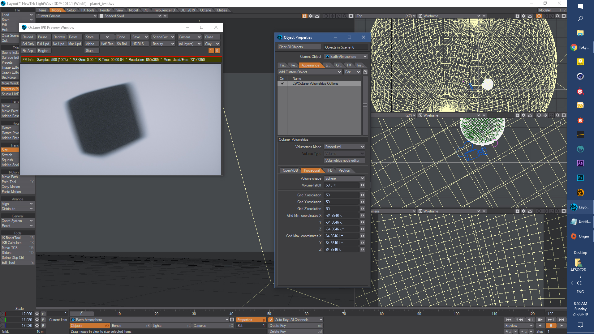

Funniest looking sphere I have ever seen, lol. Juanjo, you have some work to do my friend! And I had to increase the size massively to even get the object seen.

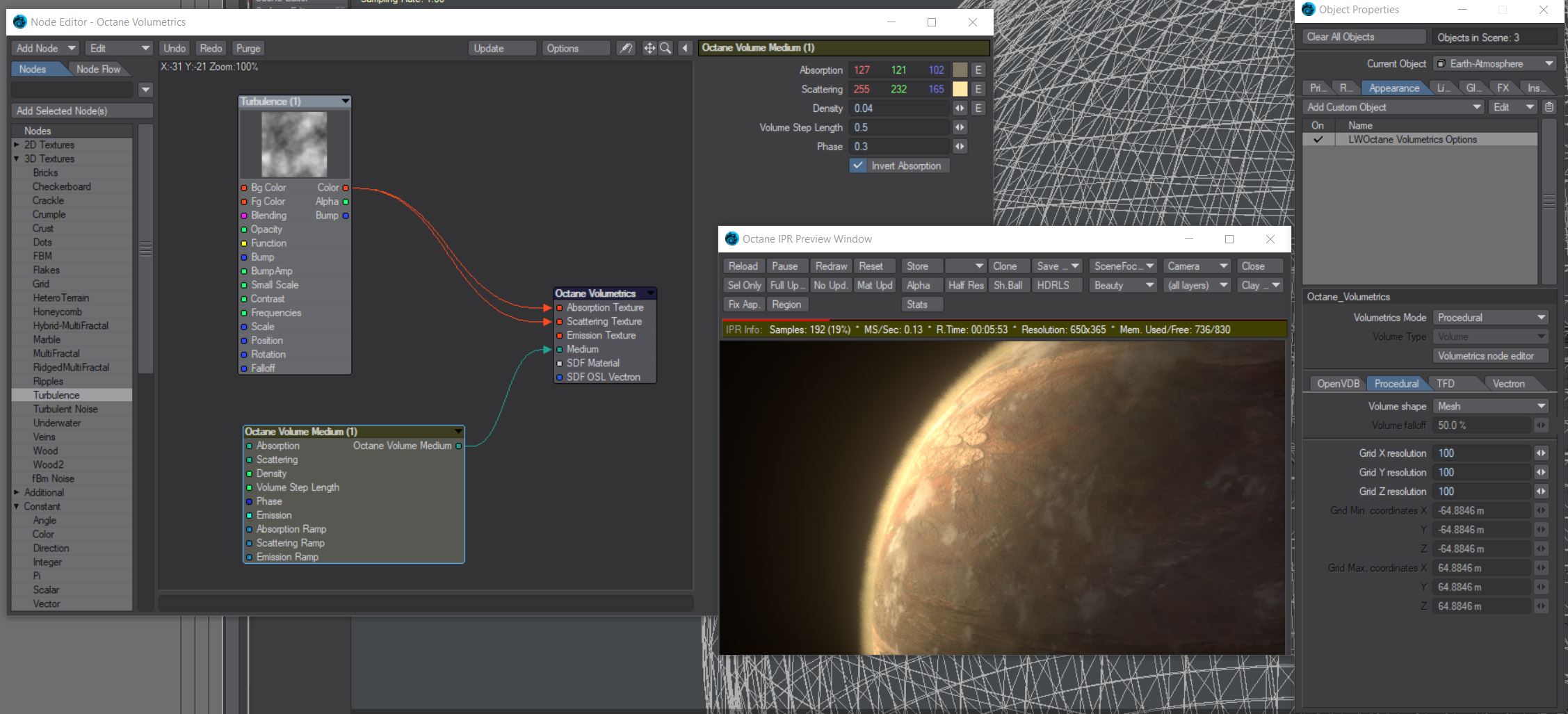

2019-07-21 11_39_39-Layout™ NewTek LightWave 3D® 2018.0.6 (Win64) - Earth-Tutorial-Setup_juanjo.lws.jpg

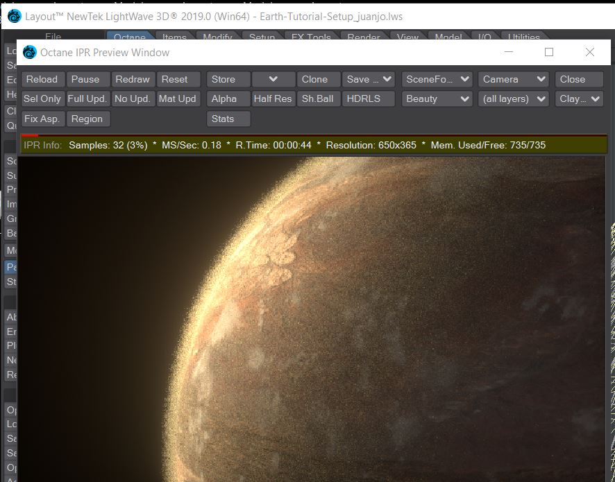

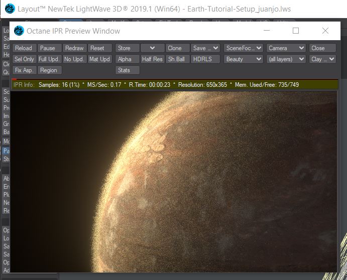

Nope, all seems to work fine also in LW2019.0 and LW2019.1 (using the current LW2019.0 plugin). I've also attached my scene. Can you please check it in your side? Be aware of things like the scene scale, the medium node settings or the triangulation of the atmosphere sphere, something needed to build the volume object.

2019-07-21 11_56_22-Layout™ NewTek LightWave 3D® 2019.1 (Win64) - Earth-Tutorial-Setup_juanjo.lws.jpg
2019-07-21 11_50_35-Layout™ NewTek LightWave 3D® 2019.0 (Win64) - Earth-Tutorial-Setup_juanjo.lws.jpg
