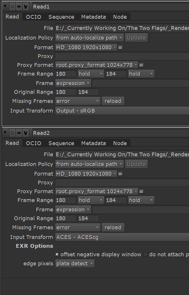

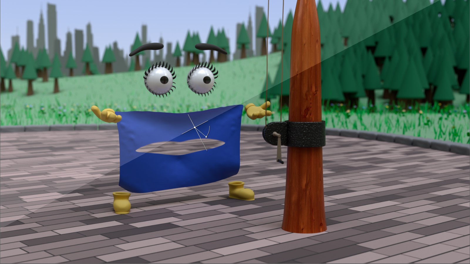

When rendering in Modo and saving as PNG with sRGB Color Space the image looks the same when importing into Nunke (with Inpout Transform set to Output-sRGB).
But when saving as 16-bit EXR and setting the Color Space toe ACES-ACEScg - and then setting the input transform in Nuke also to ACES - ACEScg) the image look very different.
In the comparison image the upper left is the PNG (which looks like in Modo). The lower right is the EXR.

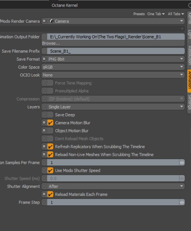

I also attached screenshots of the export settings in Modo and the import settings in Nuke.
Anyone any idea what I am doing wrong?

The input transform in Nuke must be set to the color space the file is encoded in. If that is an ACES Input Space (like of some camera), then yes, it should be set to that input color space. But if the file is already encoded in an output color space (like sRGB for a PNG), then the Input Transform in Nuke must be set to that output color space to read the data in correctly - as counter-intuitive as this might sound.
I am working with ACES happily and successfully in my usual setup (Houdini with Redshift and Nuke) - no problem there.
When I display a rendered image in Houdini with an sRGB display transform and write it out in ANY color space, I can read it in to Nuke, set that color space for the input transform and as long as the display transform in Nuke is set to the same as in Houdini, I see the same result.
But in this case even when I write the file to EXR in ACEScg space and read it into Nuke with that very input transform, the result is still different - which IMHO should not be the case.
When I export to PNG (in sRGB space) and read it in (with sRGB input transform) in Nuke, all is good (looks the same in Nuke as it looks in Modo).
So, I would love to not use PNGs and use EXRs instead (as I usually do) – if someone can tell me the right export settings in Octane/Modo and the right input transform in Nuke, I'd be happy to give it a try.

Hey elsksa,
my view transform in Nuke is set as it always is - either sRGB or Rec709 - depending on the Monitor I am viewing with (I don't have an HDR display).
As soon as the data is correctly transformed from the file's color space to Nuke's internal color space (by applying the appropriate input transform in the Nuke reader node), all should be fine. As said, I read EXRs from RedShift and Video Files from various cameras into Nuke all the time and as soon as I apply the correct input transform it looks in Nuke like it looks everywhere else.
An when I apply the correct input transform to the PNGs (Output/sRGB, as that is what the PNGs are encoded in) then, as usual, all looks fine and the same as in Modo. Just when I read in the EXRs generated by Octane, even when setting the input transform to ACEScg (the color space I set when writing the EXRs in Modo/Octane and hence the one they should be encoded in), it does not look the same as in Modo...

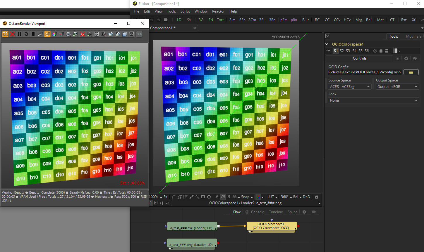

I don't use Nuke, but tested this in fusion and it looks correct with a simple textured area light.
In this fusion comparison, I'm using no view LUT.
Left = modo viewport, Octane plugin 2023.1.1.196 (using imager > ACES tone mapping)
Right, Top left = EXR16 (saved as ACEScg). Piped through an OCIO node with Source Space = ACES - ACEScg, Output Space = Output - sRGB.
Right, Bottom right = PNG8 (saved as sRGB) with no input/output transform at all
I'm guessing you have a setup problem in Nuke. I can't see an output space setting in your Nuke screenshots. It looks like you entire viewport is going through an sRGB view (?), but the EXR and PNG will need different output space settings.
EDIT: The fact your PNG has "output - sRGB" as the input transform makes me think your setup might be wrong. Not sure, because that's an output transform from the ACES config. If your viewport is set to Output - sRGB though, it would look correct. I just don't know how Nuke works.

I need to add a note here about saving PNGs with Octane. I only noticed this while testing the 2 different ways you can use ACES in Octane.
If you are using an ACES OCIO config with imager > OCIO view = "ACES: sRGB", you need to select color space = "Output - sRGB" when saving to PNG.
Selecting color space = "sRGB" will produce the wrong result.
If you are using the imager > ACES Tone mapping checkbox instead, both color space = "sRGB" or "Output - sRGB" will work for PNG saving. (NOTE: they only show up if you have a config loaded)

Hey funk,
thx for your reply.
Your hint with the Imager settings in Modo led my to the right place and I found the culprit!
In the Imager settings of Octane in Modo there are two different sRGB settings: "None (sRGB)" and "ACES: sRGB" – those are NOT the same!
I had the former, but need the latter.
Once the view transform in Modo is set correctly to the same I have in Nuke (both "ACES sRGB") all is good!!!
