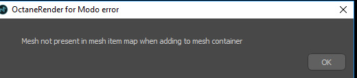

Mhmm, i also get this error Message when rendering the animation.
Is it possible that you have animated the Live Geometry checkbox for one of your Mesh items? Which frame is this message appearing? Are you able to send me the scene pls?Mhmm, i also get this error Message when rendering the animation.

I'm very sorry, but i'm not allowed to send you the scene and i was also not able to reproduce the error on another scene. Its a Scene with a complex cad Model. I instanced the model and made two different animations. I solved the problem by deleting the instance. Also i wasn't aware that many meshitems are slowing down the loading process a lot. I merged every not animated mesh. Now the loading time is a few seconds. Before it was several minutes.Is it possible that you have animated the Live Geometry checkbox for one of your Mesh items? Which frame is this message appearing? Are you able to send me the scene pls?
