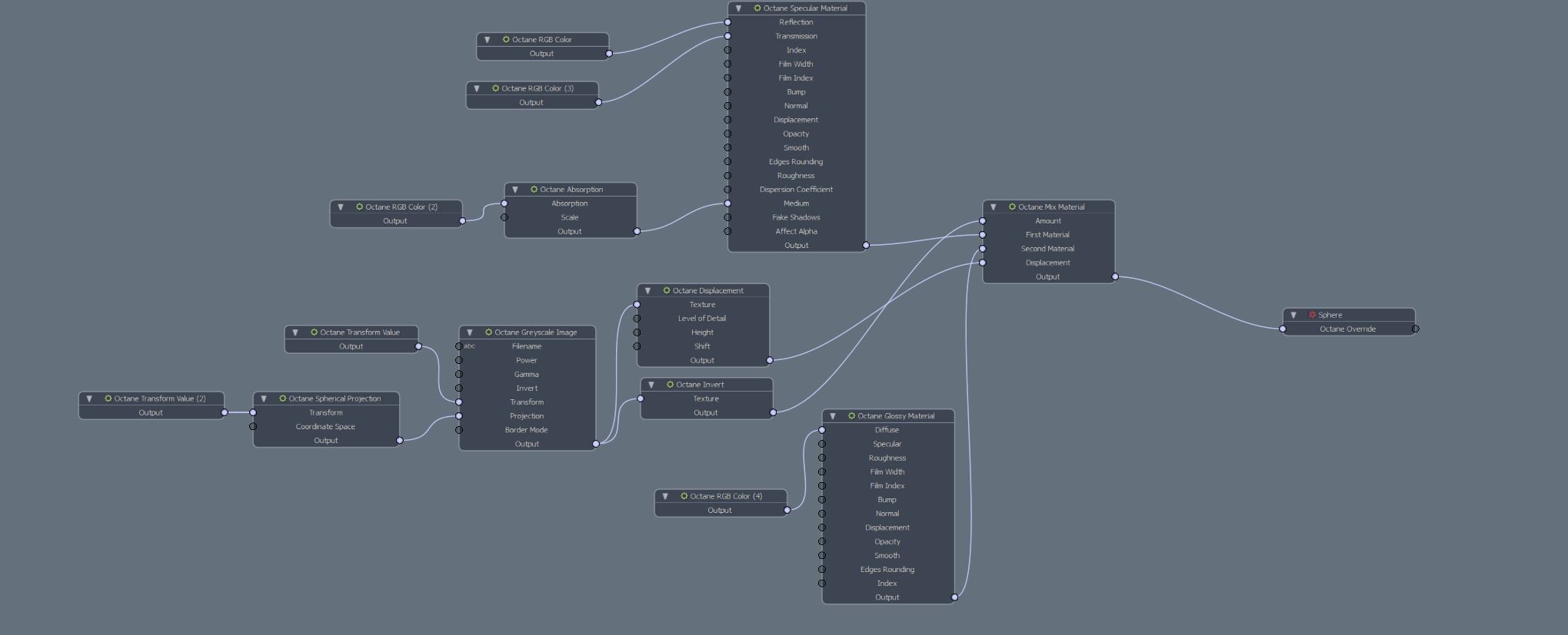

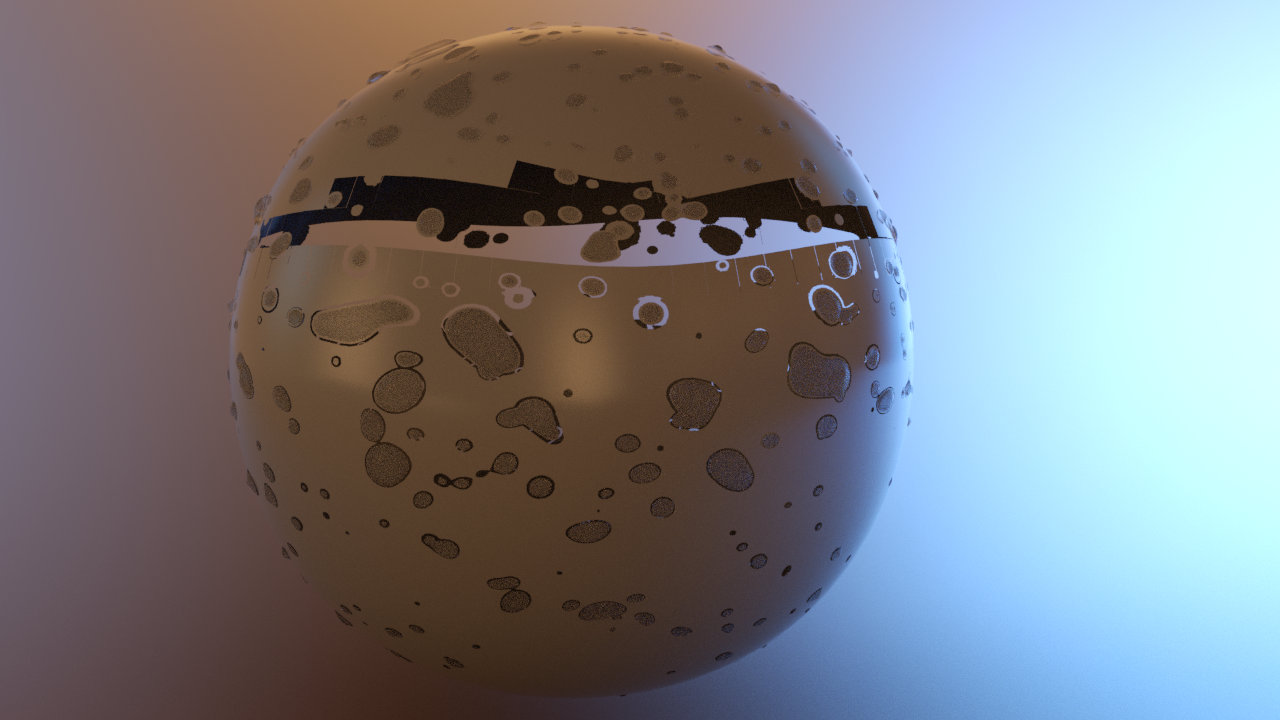

I then have a second water mesh with a specular material applied. I displaced this and then added an alpha channel to knock out the remaining area where I dont want the water...
Both meshes are the same size and I'm getting some weird interference from the plugin. Not sure what to do here but I've attached screenshots.
When I make the water mesh larger than the base mesh so its not touching I get no issue but now the drops are floating.

Try setting the Kernel->Ray Epsilon to the lower possible value it will go to.

Thank you for the reply Face.. The meshes still seem to be interacting still @ Epislon .0001 - that's about as low as I can go. I found a post yesterday where someone was able to achieve a really nice result with displacement.

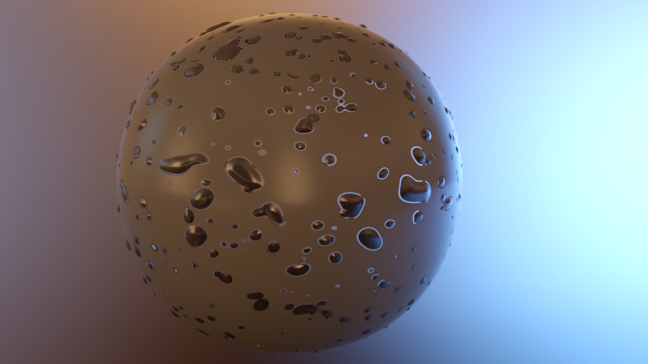

Gave the UV mapping a shot which produced a slightly better result but still getting some interaction when the drops get too close to the base. The drops get a bit floaty when I push them away from the base to combat the issue.
Ive included my drop map that was made in photoshop along with a screenshot of my latest attempt.
