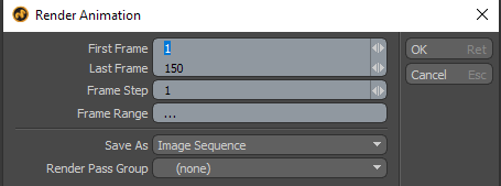

I see your script now. In general, I would have thought it easier to do this sort of rendering within the plugin. I will post a sample script below....
Paul
face_off
Posts: 15829
Location: Adelaide, Australia
Following is a very simple script to render all the Passes from the currently selected Pass Groups. Change the "filename" as required. This is had no testing, so please leave feedback here with your findings.
Paul
Code removed - please see viewtopic.php?f=34&t=78755&p=421892#p421892 for latest version.

BartvanDoornik
Posts: 14
Joined: Fri Nov 26, 2021 9:50 pm
awesome script if i could understand scripting. :)
I am kinda suprised this is not in the Plugin itself. I would love to have a dedicated button in the Octane menu/Octane renderwindow. Coming from Vray this is all in there and really handy if you need to render lots of takes.
Would be awesome if we can have a Render from Pass group popup like in Modo.
Hope you can build this in natively in Octane.
