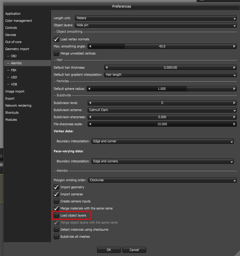

elsksa wrote:
Jolbertoquini wrote: Would be great on the USD loader to automatic add object layer node connected so we don't have to do manually all then, or is that a way to activate on the import?
Hi JO, I do not think it should be enabled by default due to how heavy some USD assets may be and loading all object layers may slow the process down, especially in situation where it happens involuntary.
I believe that the basic importer options will match the Alembic ones, and it might be expected to have USD-specific options.
I most agree I definetly would prefer we had more comun feature of USD I really would like at the least node rather then only one is some case we want unload object completely and entirely off the buffer not just hide and load taking memory space.
Octane Render for Maya.
https://vimeo.com/jocg/videos
http://www.hmxmedia.com/
Jolbertoquini
Posts: 1067
Joined: Sun Aug 31, 2014 7:08 am
Location: London

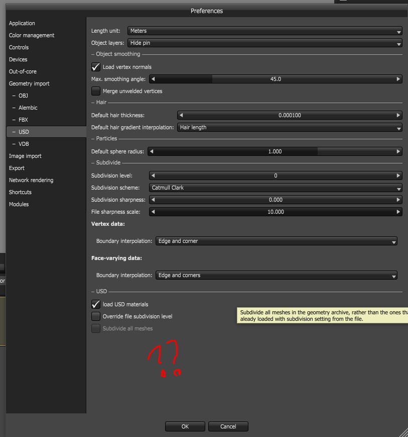

vijay_thirukonda wrote:
Jolbertoquini wrote:Thank you for the update!
Best,
JO
you can already do this. Go to preference->Geometry import->USD then make changes as you like. These are the default settings used when loading a USD scene.
Mmm Really is not visible on our preference not like Alembic just material and overwrite subdivision no object layer options.
object layers USD options
object layers Alembic options

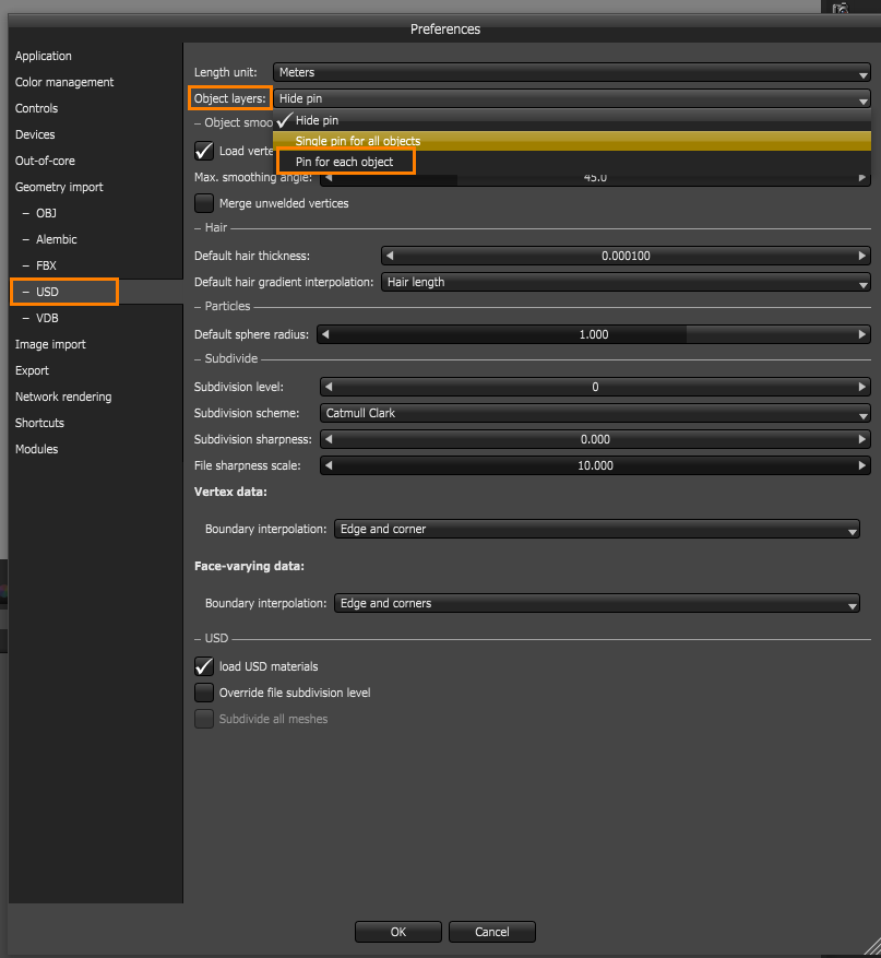

BK
Posts: 1496
Best,
JO
hi Jo,
Please try the Pin for each object from Preferences>USD>Object layers dropdown or can also be changed from the Import settings.
Cheers
Kind Regards
bk3d

Hi Bikram
Please have a look on the alembic options you will understand is not the same, when I set hide pin and activate the option at the bottom to load object layer, all object layer are forced loaded and there but "the pin is hiden" to avoid a huge node has being like this on the standalone for a while, on USD yes will load but it is missing the option to force load and the pin being hiden.
Do you undertand what I mean now?
Best,
JO
