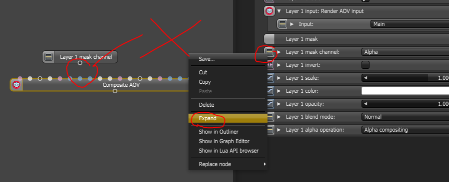

BUG: Expanding nodes on composite aov does not connect expanded node
1. Add a composite > composite AOV
2. In the node inspector, right click on any pin icon > expand
RESULT: The node is expanded, but not connected to the pin.
I'm guessing this is somewhat related to the previous bug I submitted with the composite texture.
Win10 Pro / Ryzen 5950X / 128GB / RTX 4090 / MODO
"I am the resurrection, and the life: he that believeth in me, though he were dead, yet shall he live" - Jesus Christ
Goldorak
Posts: 2321
Joined: Sun Apr 22, 2012 8:09 pm
funk wrote:BUG: Expanding nodes on composite aov does not connect expanded node
Yes - I ran into this too.
vijay
Posts: 197
Joined: Sun Jul 24, 2016 8:42 pm
Thanks for the report this will be fixed in the next build.

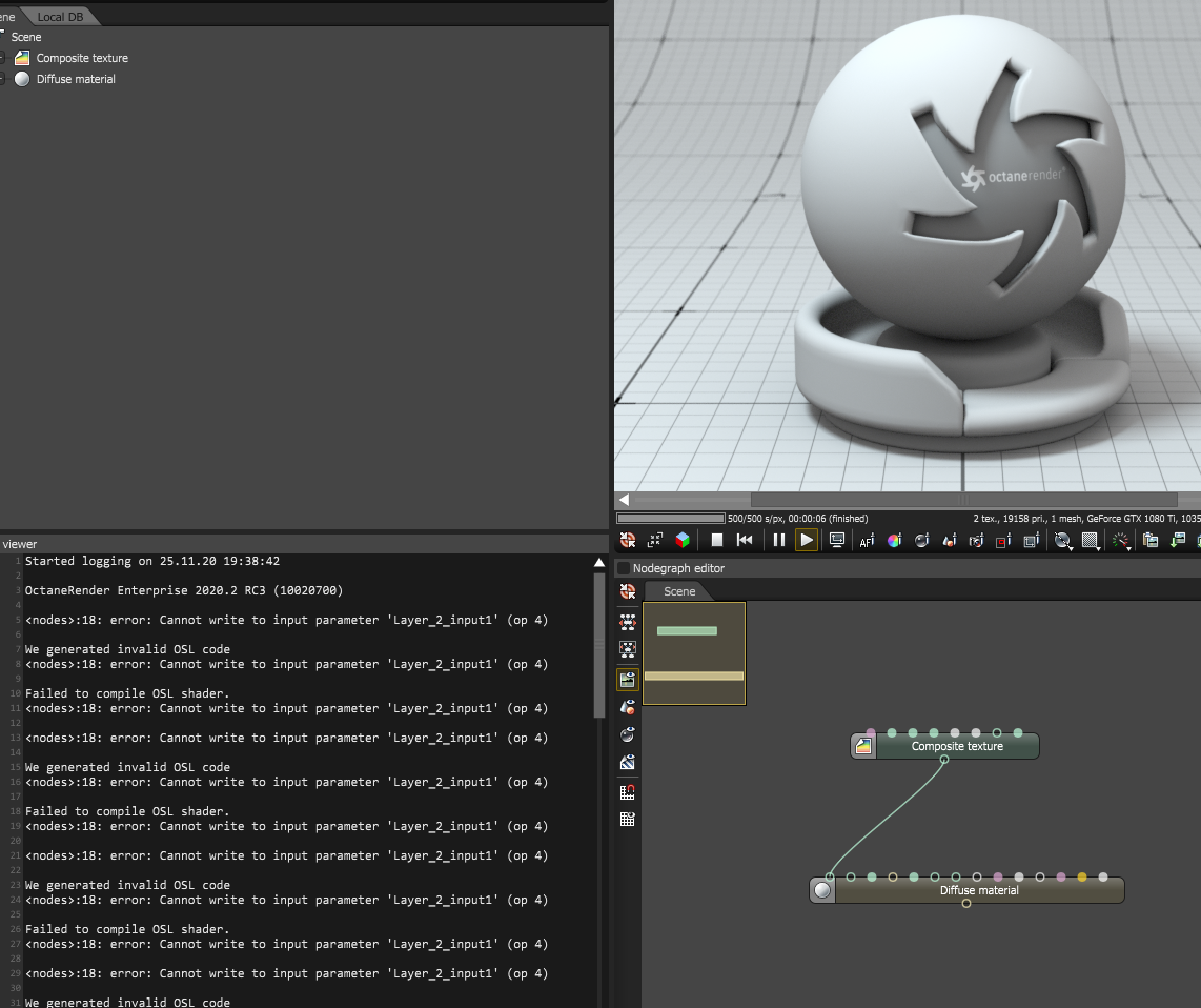

funk
Posts: 1207
Joined: Mon Feb 07, 2011 1:24 pm
Location: Australia
BUG: Composite texture generated invalid OSL code
It seems like the previous post is very simple to reproduce.
1. Load the attached OCS
2. Open a windows > create log window and dock it.
3. Right click the diffuse material > render
The following log error occurs:
Code: Select all
Started logging on 25.11.20 20:32:43
OctaneRender Enterprise 2020.2 RC3 (10020700)
<nodes>:18: error: Cannot write to input parameter 'Layer_2_input1' (op 4)
We generated invalid OSL code
Failed to compile OSL shader.
composite_texture_invalid_osl.ocs
(36.48 KiB) Downloaded 457 times
