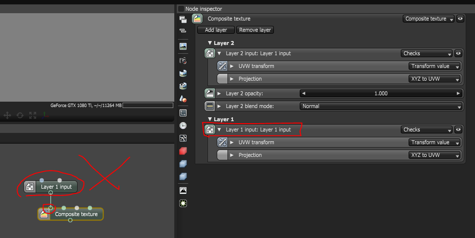

BUG: Composite node mixing up pins and layers when expanded
The composite texture is really awesome. I think it may become my favorite node. Its going to simplify nodegraphs that required chains of mix textures etc
But I'm finding it a bit buggy:
1. Add a composite texture. NOTE: If you hover over the node inputs, the far LEFT pin is layer 2 input, while right is layer 1
2. In the inspector, set layer 1 input to "checks"
3. Set layer 2 input to "noise"
4. In the inspector, right click the layer 1 input icon > expand
RESULT: The checks node expands but is attached to layer 2 input pin, which is wrong. It overwrites the previously connected noise node.
If you add more layers, and do the same thing, they get connected to the wrong pins too.
If you save the file and reload it, the composite node now has TWO checks nodes connected. The noise node was overwritten.

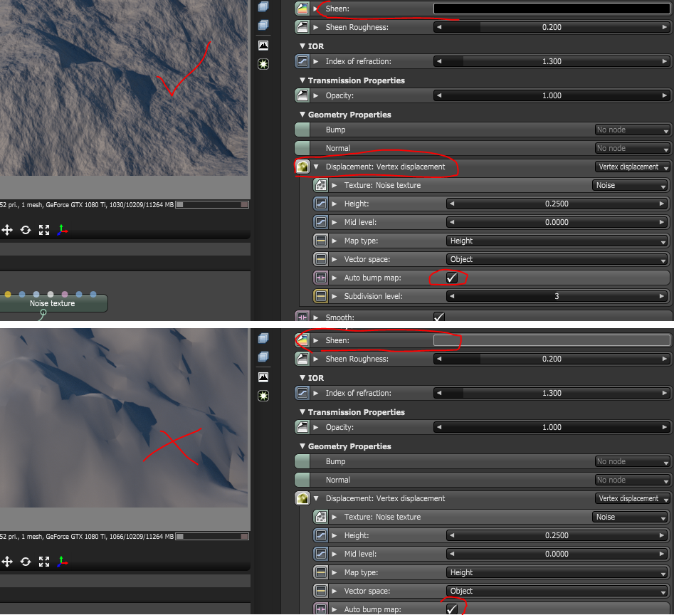

BUG: Vertex displacement autobump breaks if you add sheen color
1. Load the attached scene and select the rendertarget to start rendering
2. Select the glossy material and change the sheen color
RESULT: Autobump stops working.
displacement_autobump_breaks_with_sheen.ocs
(77.83 KiB) Downloaded 455 times

funk wrote:BUG: Vertex displacement autobump breaks if you add sheen color
Thanks for the report, I have fixed this and the fix will be in RC2.
