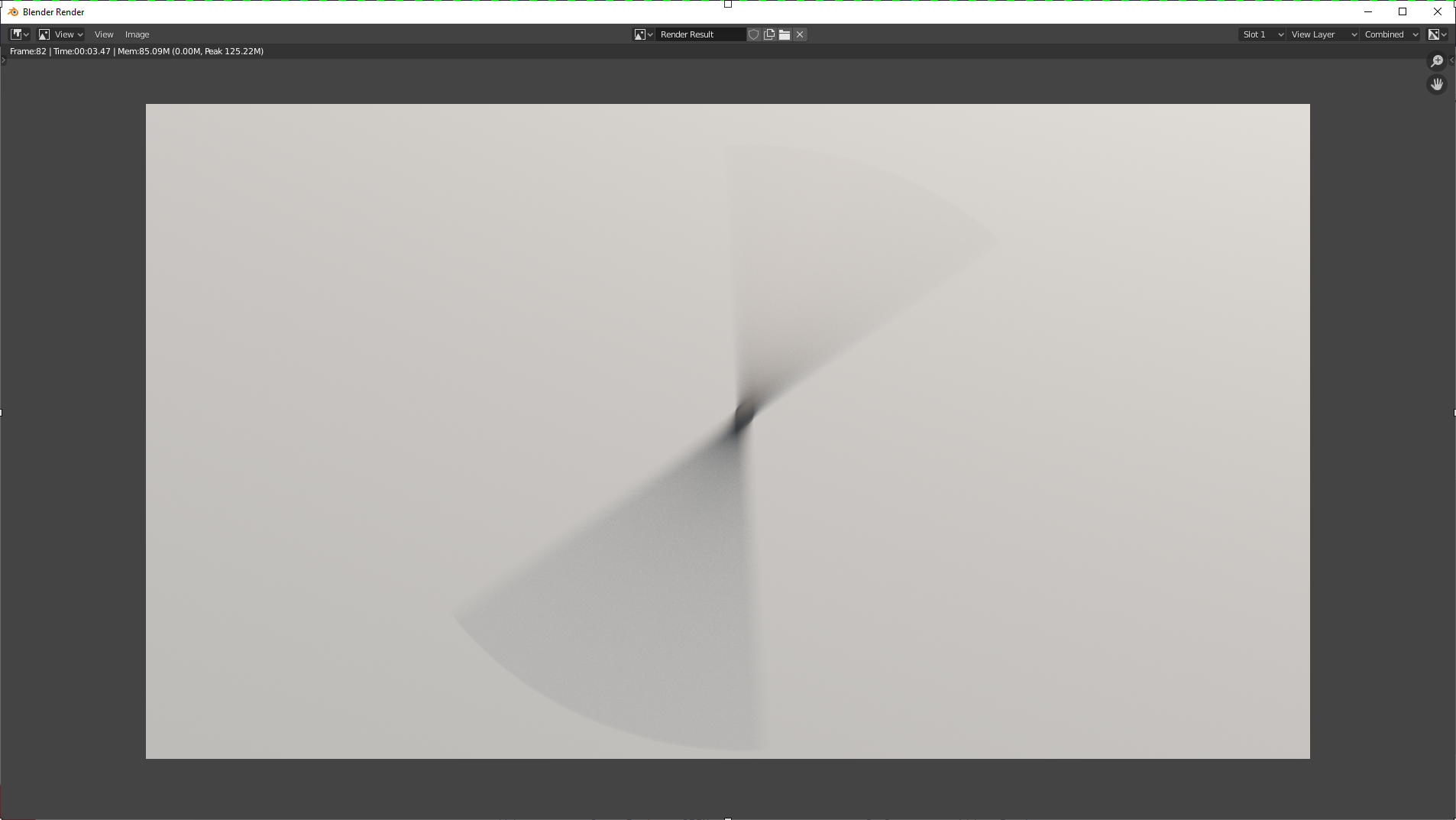

PolderAnimation wrote:Question about motion blur.
Is it correct that Octane does not understand angular velocity? If so, this would be extremely useful to get nice motion blur arc.
I also tried and alembic with sub-frames for a nice smoother arc in the motion blur but that does not seem to work either. Is that correct? or am I doing something wrong?
edit: the sub-frames do work, but the angular velocity or W attribute (houdini) still doesn't work.
Sub frames are always needed to get effects like this one:

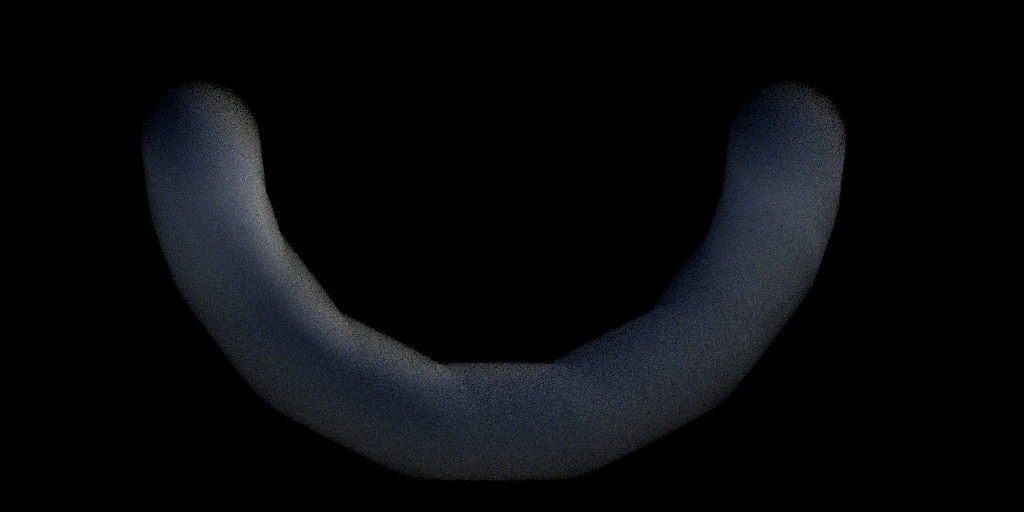

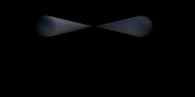

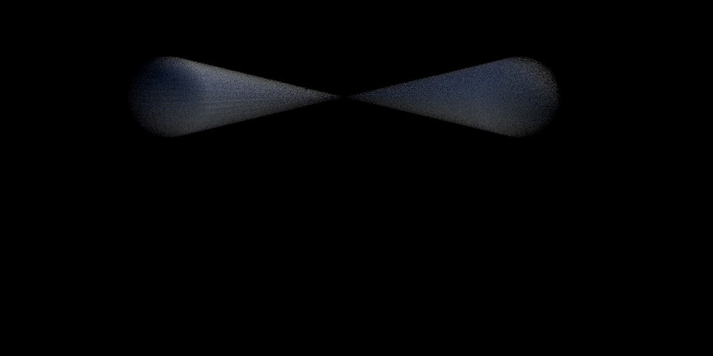

Another motion blur question.
Here two tests. I have a sphere that rotates 180 degrees in one frame.
The first one has rotation keys on the object is self, the second one has a vertex position cache (both have sub frames).
As you can see the one with the vertex position cache has wrong motion blur. So for all animated characters with subframes caches, the motion blur is wrong.
I have attached an orbx, if you slide the shutter time you can see where things go wrong.
