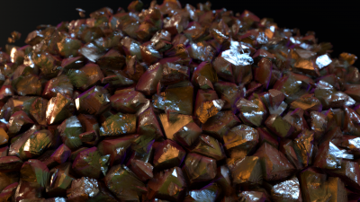

Maybe my PC is a weak POS, but man...when a Vectron scene does work, it really struggles almighty to render the scene.
For 1 texture I would think it could go super fast, it is supposed to have a low geometry cost, right? (the geometry doesn't even say what it is...)
Whatever this Vectronian thing is my GPUs are busting their a$$es off....
This was 2:30 for 300 s/px @1080p on a zoom-in shot.
But when it does finish, really cool, I can almost feel the larvae growing in the mutagnic pod-sacks.

There are some issues in RC1 where SDFs would render super slow if there is any positive scaling in the scene. This will be fixed in RC2.Notiusweb wrote:Maybe my PC is a weak POS, but man...when a Vectron scene does work, it really struggles almighty to render the scene.

Sampling lights from hits on the surface is not nearly as expensive as tracing the geometry. Which is why we're looking at ways to speed it up.
