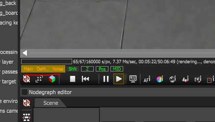

Now that I have denoising working on the 670, while the 1080ti renders, I decided to test a 4K (3840 x 2160) denoise.
It works, but it's not very fast. I also noticed that having "denoise on completion" disabled, makes switching passes very slow. If I try to switch between passes, it's like the UI gets stuck for a while (I see several pass buttons highlighted instead of just 1), until octane recovers
I have a feature request. Could we have a "denoise NOW" button, or a "denoise on PAUSE" feature?
This would allow me to let my render cook and denoise it only when I want, or if I pause the render to save it.
EDIT: I also tried doing a render with denoiser off, then enabling it later, but it restarts the render :(
EDIT 2: Found a workaround for now. Start the render with denoiser on and "denoise on completion" on. When the render gets to a point where you want to denoise, uncheck "denoise on completion", wait for the denoise to happen, then check it again to prevent the denoiser from running.

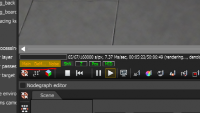

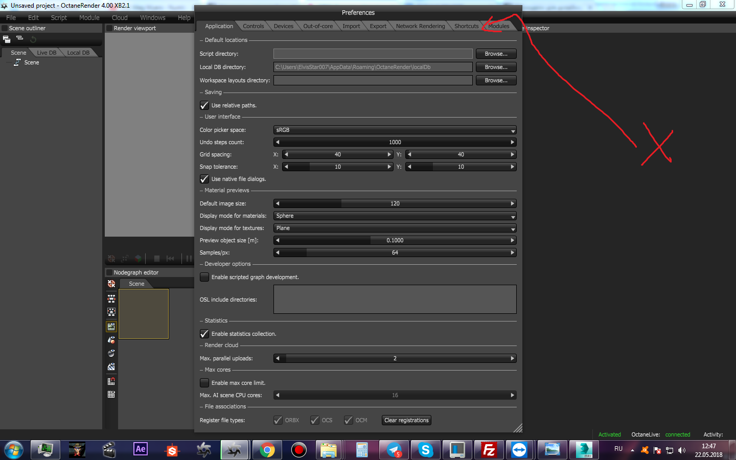

Elvissuperstar007
Posts: 2614
Location: Ukraine
this panel can not be closed
