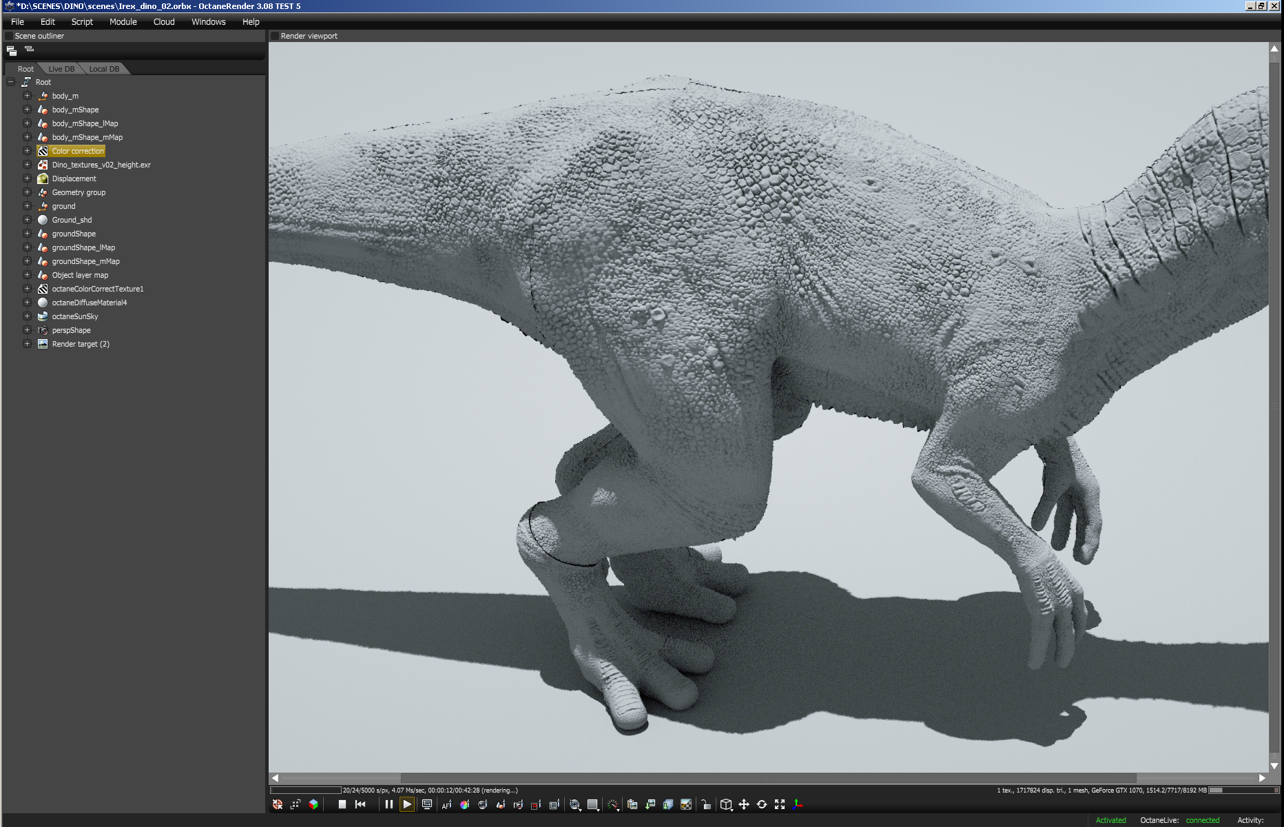

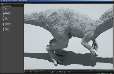

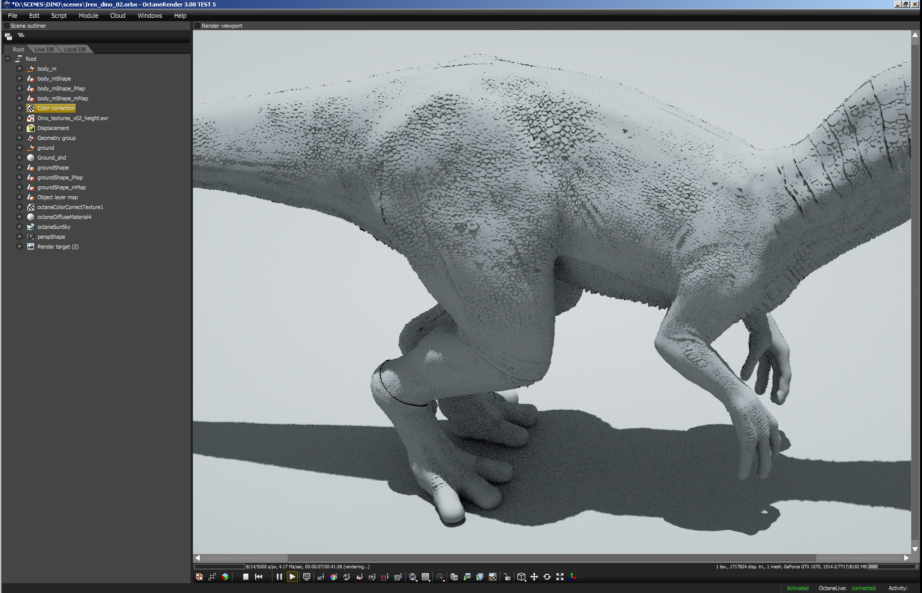

Jolbertoquini
Posts: 1067
Joined: Sun Aug 31, 2014 7:08 am
Location: London
hum... same here really hard to get details on displacement, I need add bump to get right. but stills the gaps.
I attach renders and scenes... Please anything wrong I tested on Redshift, Iray, Arnold same setup all good out of the box.
this is a free scene from Truong CG Artist.
Cheers
JO

FrankPooleFloating
Posts: 1669
Joined: Thu Nov 29, 2012 3:48 pm
Ugh.. I was so excited to have displacement working right.. don't think I will bother to download this version... :cry: I'm sure they'll get it right soon though...
Hey, I love the dino without claws attached!.. Kinda like a Ticklesaurus Rex! ;)
