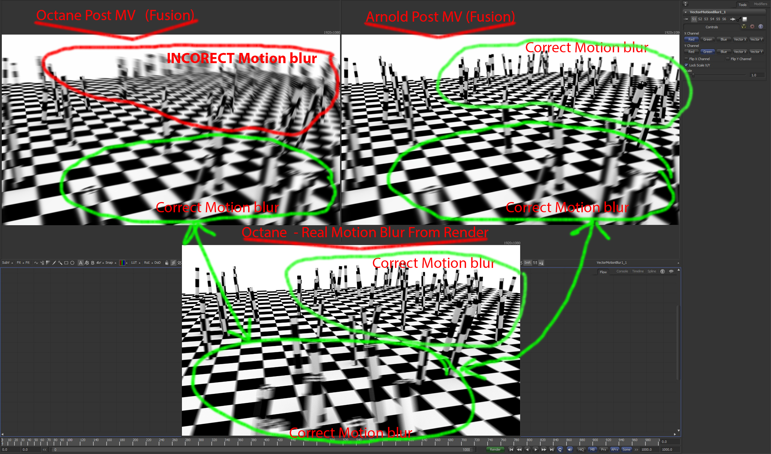

We did some test with Standalone 3.06 test 3, with Motion Vector, Basically the results is really different of the motion blur rendered with Octane the "internal" mode we use on maya plug and standalone we have same problem after we test the same scene use only motion vector from Arnold we get the same result as the standalone 3d motionblur render.
I attach at this message orbx scene exr renders and a image to explain the case. Please let us know if is settings or something on the software there is fusion but same issues on Nuke and AfterFX.

Yes right, motion vector pass in Octane is a joke,
I guess nobody in Octane team ever tried to use it.
I measured the value of the vectors and found that the distance from the camera doesn't affect vectors.
If 2 Objects have the exact same movement but one in front of the camera, the other very far, they will have the exact same vector ...
This is absurd as obviously the object near the camera need a way stronger motion-blur post effect.
So ok, this is not a vector pass but a velocity pass and we need to take care of the distance from camera by ourself...(z component of the camera space)
So I tried, I divided Vector pass by Zdepth pass and magicaly the post motion blur begin to looks like the rendered motion blur.(also the the ridiculously low values of vectorX(red) and vectorY(green) doesn't help)
but even this way the post motion blur feels very low quality , still very far to the quality of Arnold motion vector pass.
On the other side, Arnold motion vector almost match exactly the Octane rendered motion blur

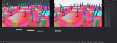

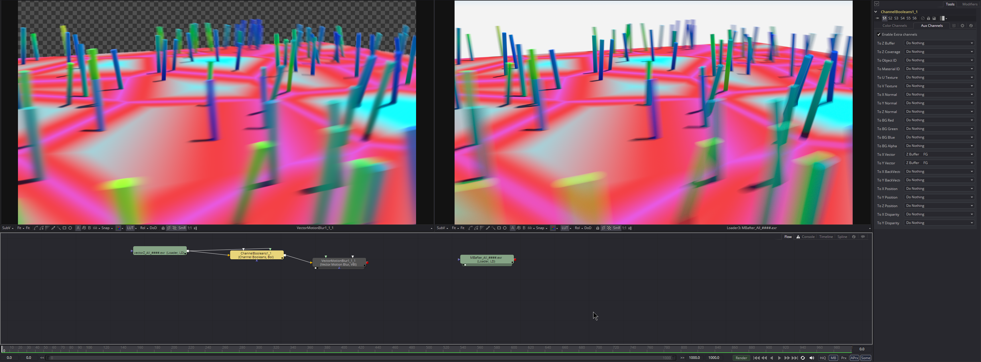

- here is a simple scene, with 2 sphere one just in front of camera, the secon very far, both sphere have the exact same movement at the same speed, look at frame 4, I exported the MV pass, open the pass in a hdr capable editor and pick color for the two sphere, they have the exact same color/vector, this is wrong, obviously the background sphere need much less motion blur than the near sphere.

Yes, I can confirm that the viewport transformation isn't applied to the motion vector (it seems it was always broken). It's too late for the upcoming test 4 release, but we will fix it with the release after that.
