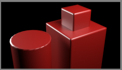

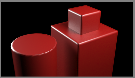

I'm using the orbx posted here: viewtopic.php?p=297036#p297036
I'm still getting artifacts on the cylinder. Is this right?

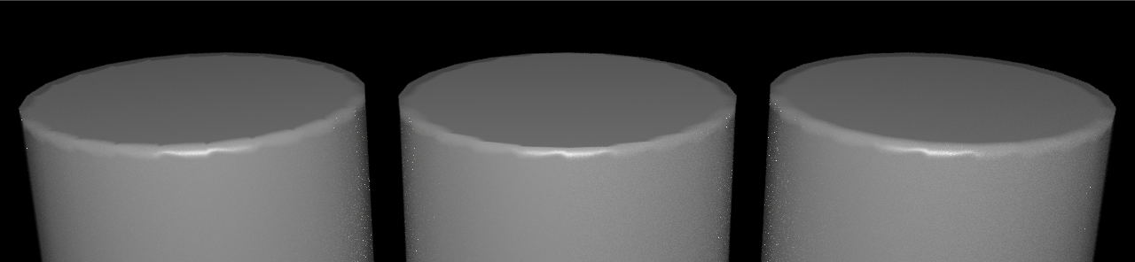

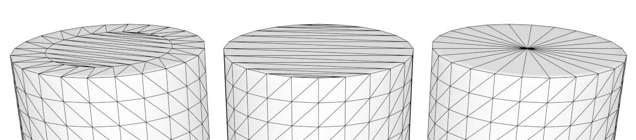

The scene I gave Paul is no longer crashing: viewtopic.php?p=297165#p297165
It's 3 cylinders with different topology used on the top "face". All have vertex normals as well, but check out the results:

funk wrote:I'm still getting artifacts on the cylinder. Is this right?

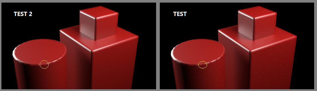

This is the bug that has been solved, please note the difference near the cylinder caps where there used to be a discontinuity in the previous version.
Difference in discontinuities near the cylinder cap
Unfortunately this implementation is still bound by the geometry, and it is meant to be an incremental improvement so you can already have a usable version to work with before the new one is available, which in contrast to this, should not produce this type of artifacts.
Also, take into account this is producing an illusion by bending the normals so if your camera is too close to the geometry or the edge size is large compared to your geometry size even an optimal implementation will not look realistic.

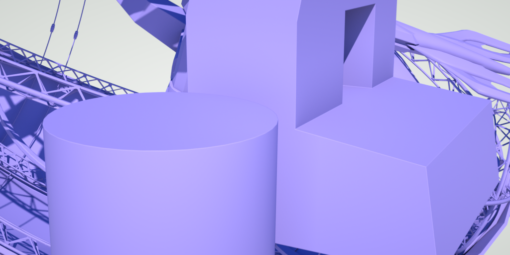

I have perfect results now even in the cylinder corner case. (default cylinder from Maya)

The first example you provide, the red cylinder, has a cap made of one ngon....so that's not even worth discussing.
For the second example with several topology cylinder,
I don't have have this artifact problem with cylinder coming from Maya,
I guess there is hard edges everywhere, so the result make sens.
For round edges to work you still have to provide correct geometry and normals,
round edges are going to happen on hard edges,
so for a cylinder hard edges should only be between the cylinder and its cap, edges along the length should be smooth.
In fact in my tests Octane now do a better job with rounded edges than some other renderer.
