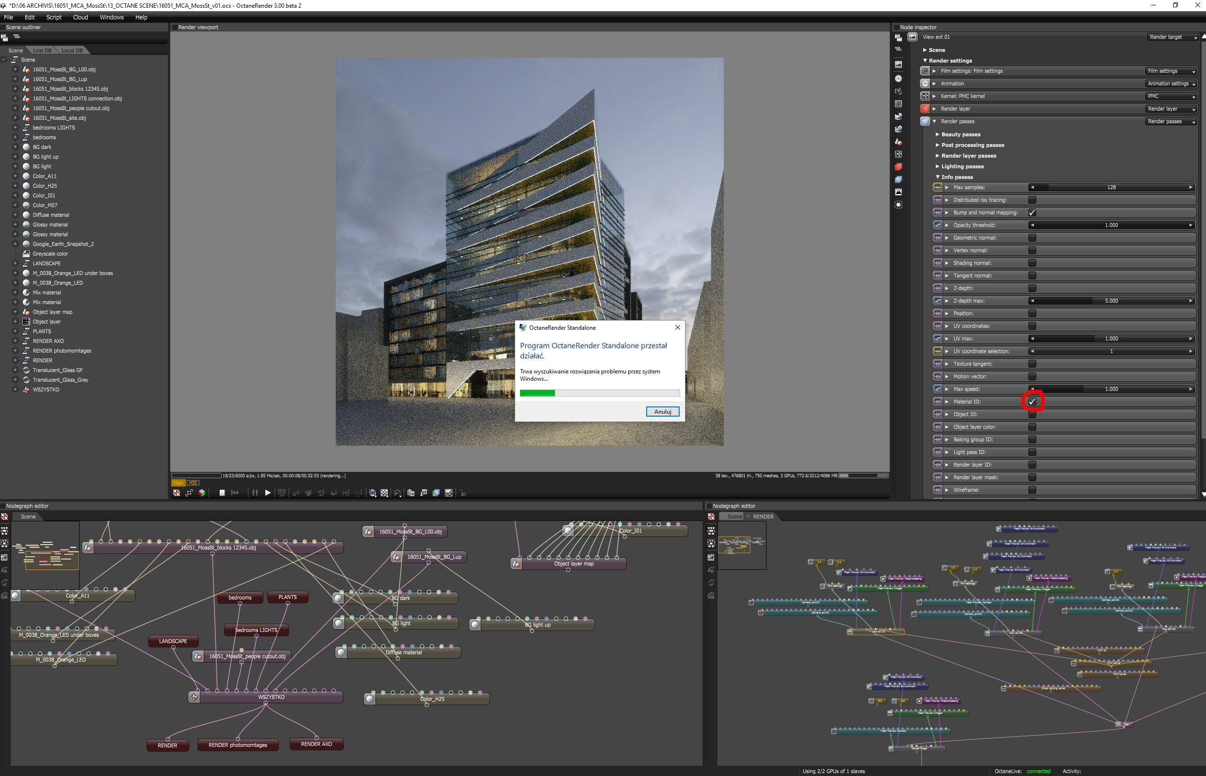

Location: Poland
and when I tick MaterialID box in Info passes, Octane 3.00 Beta 2 craches!

ssokol wrote:and when I tick MaterialID box in Info passes, Octane 3.00 Beta 2 craches!
Couldn't reproduce it either. What crashes? The application or the kernels? Could you send us an example scene? Which OS are you using?
ssokol
Posts: 68
Joined: Thu Mar 22, 2012 8:39 pm
Location: Poland
I'm working on windows 10, GTX titan X, 2x 970. latest CUDA drivers....
Octane application craches.
