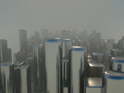

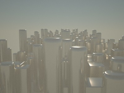

Hi, fog medium in daylight doesnt work, it produces a solid fog everywhere. I used the old method and is fine. Check 2 pics.
All i do is add a scattering in daylight medium, make scatter white and play with density but not working. Am i doing this wrong or is it a bug? thanks

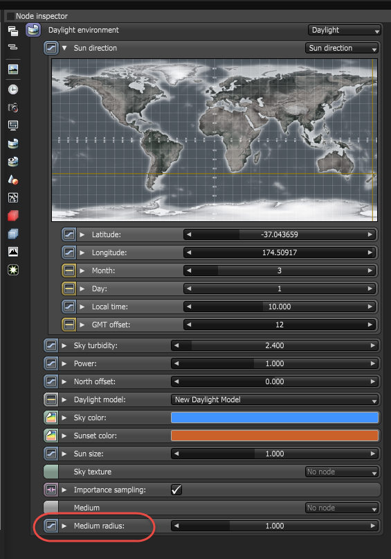

It may be that your geometry is placed outside of the medium radius. Try to play with this parameter.

Its not the medium radius. Im inside 3ds max btw and not standalone. And yes, i do not want to use daylight to have this. I wanna have fog in any situation
