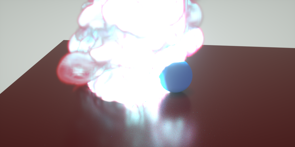

The unitless VDB files now are emitting, great!
When I loaded the scene last it was before it was working, so now when I opened it up I had to lower the power because it was so bright.
Nice!
I didn't bother to render it beyond 6,000 samples to clear out the unrendered reflection pixels on the red plane.
What can help again to make those go faster, GI Clamp, Ray Epsilon and Path Term power if it's in a dark area/shadow? Right?
Thx!
