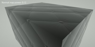

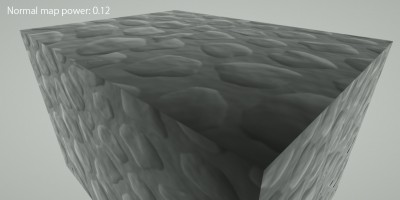

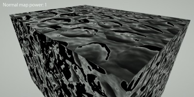

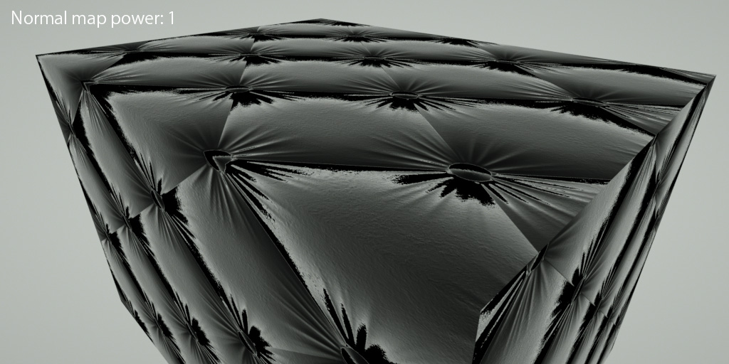

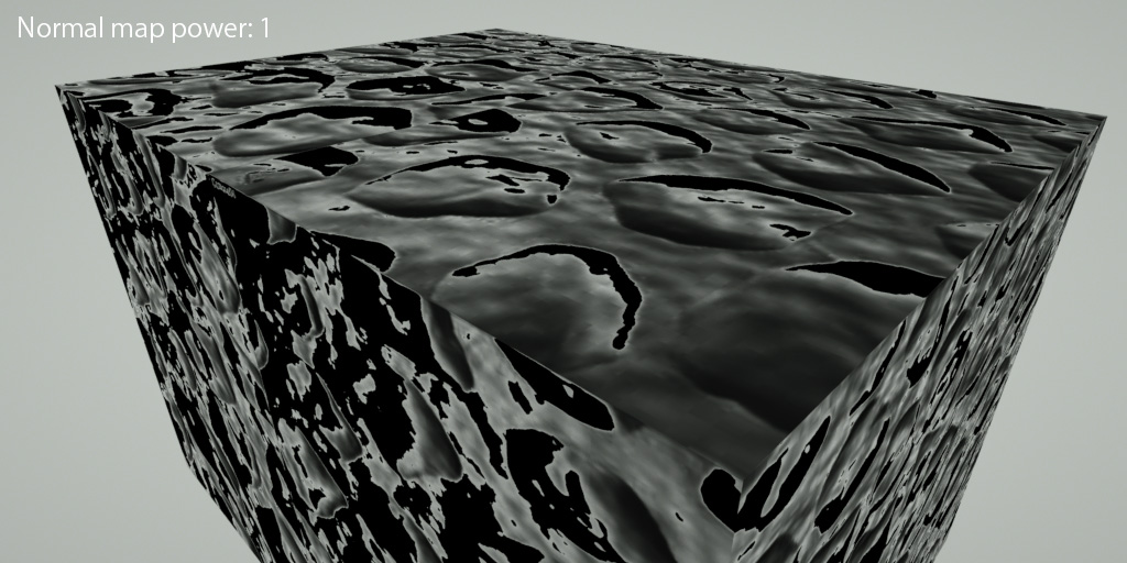

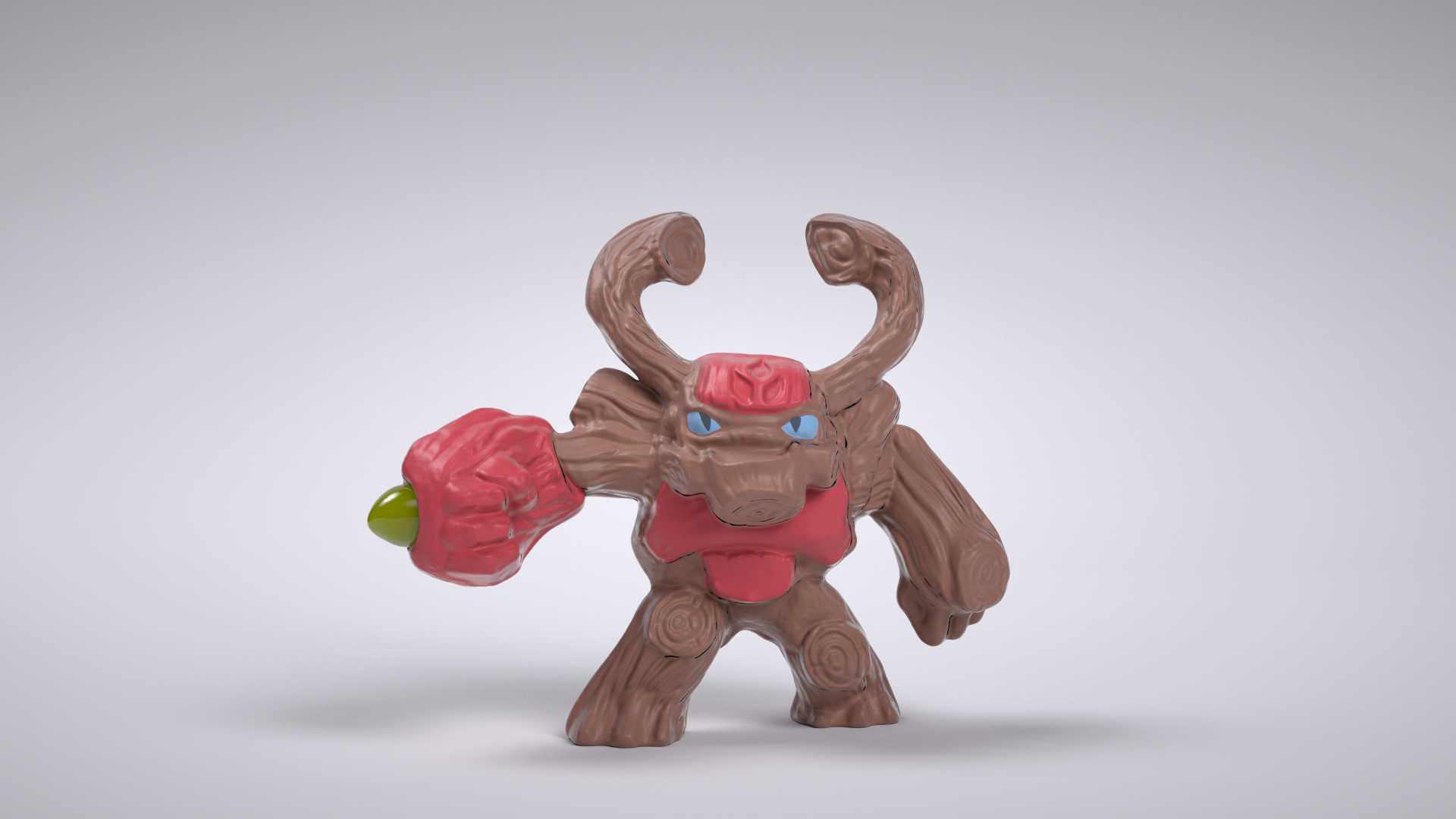

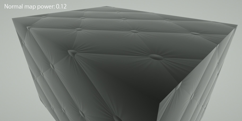

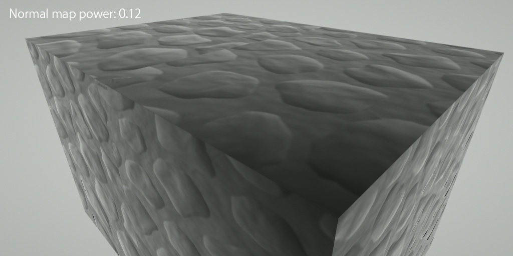

Long story short, if I apply a normal map with power of 1 (which should be 100%) I get horrible black spot all over the place, it seems that when the range of brightness goes too high, Octane clips it out and make those areas black! :? If I reduce the power of the normal map to something very low, like 0.1, the black goes away, but obviously the normal map details are very weak.
Here some example, please note that this issue happens with any object, and any normal map.

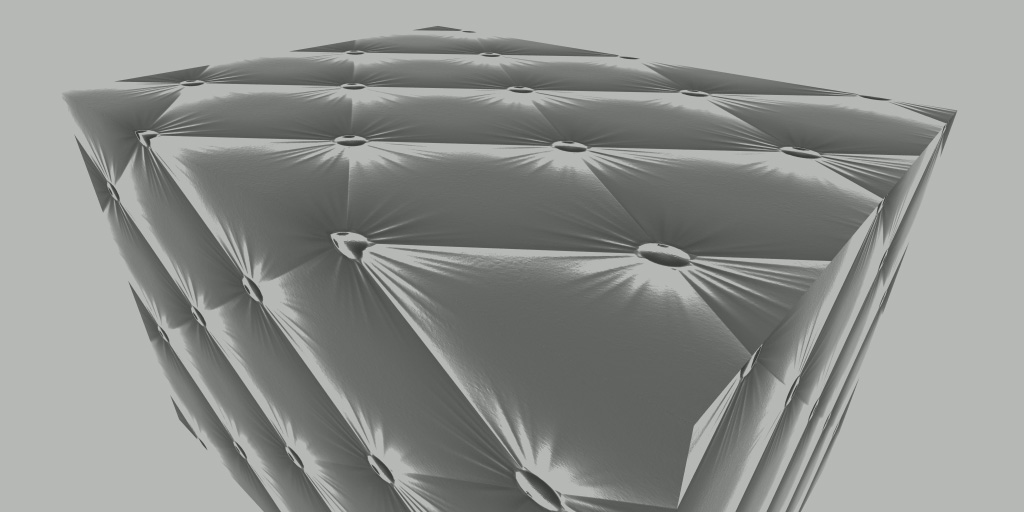

Just for the sake of the test, I did the same render in Vray, and it comes out correctly.

We have solved this problem a while ago for shading normals, but not yet for normal and bump maps. The problem occurs when the shading normal deviates too far from the face normal. For now you can only avoid this problem by avoiding too strong normal maps or by baking the bumps as geometry.
You shouldn't get different results if you use a 16-bit map vs an 8-bit map.
