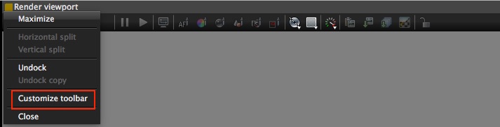

Another minor thing, I can't seem to be able to move the render bar on top (the one with all the buttons, play, pause, focus, etc). I know it's stupid, but I was used to have it on top, and it feels weird to use it at the bottom... :oops:

Rikk The Gaijin wrote:Another minor thing, I can't seem to be able to move the render bar on top (the one with all the buttons, play, pause, focus, etc). I know it's stupid, but I was used to have it on top, and it feels weird to use it at the bottom... :oops:
+1 I also was looking for the settings button to move bars to other locations :)
Posts: 10646
Hi amigos,
just right click in the upper left little square to expose all the options ;)

bepeg4d wrote:Hi amigos,

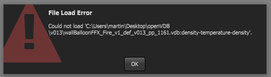

I still have issues with open vdb from fumeFX. I do get e new error message tho... Hope that this can get fixed soon. The test VDB's reads fine in Vray...

We have fixed this issue and will be released soon. Thanks for sending the vdb. A possible workaround for now is to try to export the vdb with channel name "density" - you can also try to change the channel name to FireFuel in your import preferences for VDBs.

Didn't work for me.. :( Looks like it was still looking for density and temperature despite the channel-name-change.
