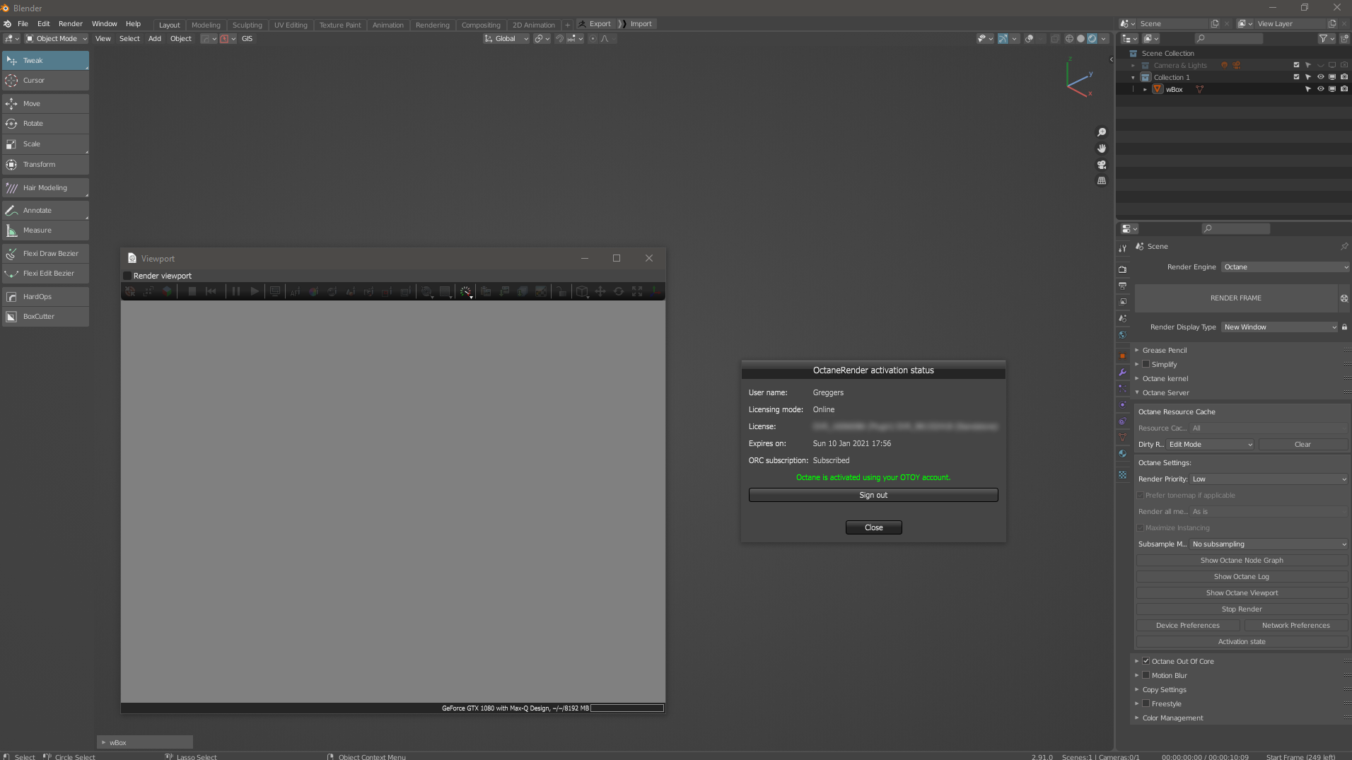

Hi Lino, Bringing up this post again.
Due to me using C4D again and updating to the latest octane for it, I decided to use Blender studio rather than the Prime version.
Ive installed Blender Studio and Octane server for the latest version but when I open blender, set the renderer to octane I just get what you see in the attachment. Nothing Renders.
I uninstalled Prime and the Prime server and I also have the octane addon ticked. Any advice would be really appreciated.
linograndiotoy
Posts: 1539
Can you check the version number of your Studio Drivers?
Remember to never use Geforce Experience for this (uninstall it if you have it on your system).
Always install drivers manually, downloading them from the NVIDIA wensite directly.
